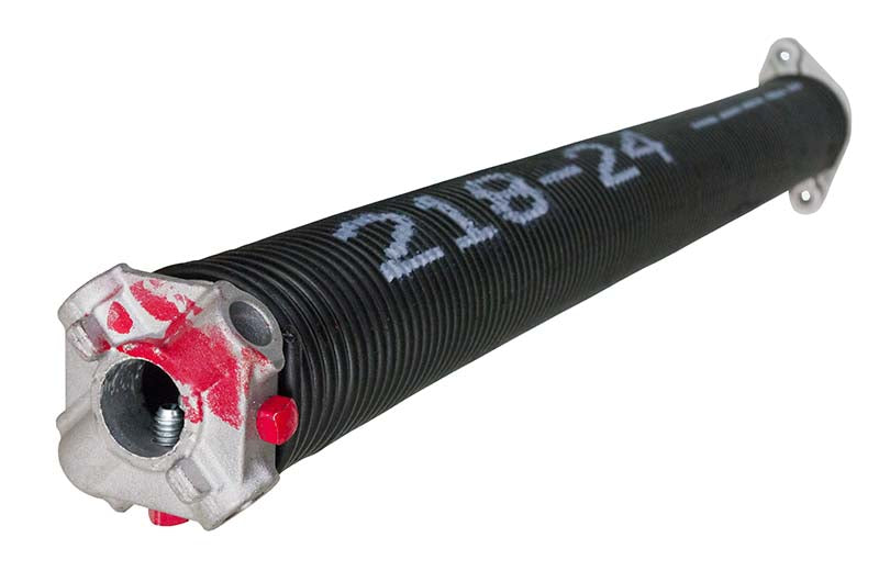

Wasn't sure where to put this, so putting it in general. I need some advice on how to fix my garage door. Yesterday, the big spring above the door broke. I can still get the door open if I lift while my wife pushes the button, but that door is dang heavy. Is that something I can fix myself, just replace the spring? If so, garage door repair where do I get it, and how do I make sure I get the right one. Do any of the Home Improvement stores have a repair service? Do I have to replace the whole lift mechanism?
Sorry if these are stupid questions, but haven't been able to get much info on my own. Stopped at a local home store, but the Garage guy had the day off.
The first thing would be to determine what size springs you have. If they are common, you can probably get them. Oddball stuff is still hard to get.
Basically you need three dimensions, the wire size, the unwound length of the wire, and the inside diameter. Sometimes the springs are marked in the unwound state, but not always. You should be looking for something like .225-2-25.

One thing a door guy years ago told me was to oil the torsion springs yearly and they will last 2-3 times as long. Oiling reduces the friction rubbing on the the coils opening and closing everyday. And making opening and closing much quieter.
Done right - springs can't rub as they're stretched slightly at full tension - so there's no coil to coil rub.
Some people go insane with the lube, it's not really needed.
It's all microfracturing - while there's some argument for oil tempering, it requires heat.
Cycle life is what it is, there's a calculator, you can set the life for as small or long as you like - but you're paying by the inch for spring wire so cost goes up with the length and lifecycle

The standard cycle life in the garage door industry is 10,000 cycles. Spring under 10,000 cycles are considered overstressed and are not recommended for use. If you would like to have more than 10,000 spring cycles, your new torsion springs will need to have a larger wire size.
The larger the wire, the longer it will take for the spring to break as thicker steel requires more bending before it breaks.
If you increase the wire size of your springs, you will also need to increase the length to keep the same lift and torque rating. On narrower, heavier doors it may also be necessary to increase the inside diameter to provide enough space on the shaft for the springs to fit.
