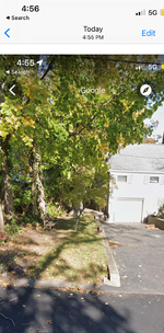

Hi,
currently have a split level house with a one car garage. I don't have a basement but a crawl space. I am tossing around a few ideas in my head. The easiest option would be to put the garage in the yard but that would ruin the space in the yard. The next would be to build to the left but I would be really close to my neighbors walkway also I would have to put an additional garage door in the rear so I can to go to the yard with lawnmowers and other items. I would then remove the load bearing wall in red with a beam going across. The final and most expensive option which is to excavate below the house and create a basement and underground garage. Any thoughts would be greatly appreciated. The 2 cars aren't big about the size of a 2009 Toyota Corolla. garage 2.pnggarage wall.png

Going to the left might be the easiest, my neighbor and I will split putting in privacy trees since the currents trees are not that good. Our properties are relatively close to each other anyway. I'll still have a emergency walkway as there is a variance of 2' from the property line, I might just go another feet or 2. I was also considering building a long 1.5 wide garage on the backyard so instead of going wide I would go along the fence.

No one likes the idea of going towards the left? That's all unused space, the only annoying part would be opening 2 garage doors and technically going through the house to go to the yard. I have a small entrance to the yard to the other side, but it's simply walking no machines or anything can go on that side.

Going out to the left is doable. I have had that done twice on different houses. The problem I see is the windows to the bedroom that would be gone if you did a typical truss supported roof. 'Maybe' you could do a shed roof that starts just below the windows but there are requirements for a minimum slope which would limit how wide it could be. You could fudge that wider if you could accept the outer wall being shorter. This pic is for a room addition but it gives the idea on the roof.

I would go to the left and have the rear door making it a "drive-through"

I like the one car wide addition on left. Less money spent on tearing up what is there, and more square footage is usually a plus at sales time.
My concern is setback and side yard line. Even if zoning doesnt limit you, building codes might, usually requiring 5' from property line.
One other option if you can live with a tandem garage, a one car addition on front, so no major widening of driveway as left will require, and do a flat roof that is habitable - a "deck" of sorts. Could be quite pleasant. Does not disturb much, even reuse garage door to save money. Very simple, just don't pinch pennies on roof membrane.

The issue with going to the front appears to be that your driveway is going to drain into the garage. Not many "good" options here unfortunately.

If you go to the left, go as far as you can. Since its attached to the house that means you need a full foundation wall, assuming you need to go down at least four feet, or full depth to the current footings. Also, you have some grade there to deal with to the neighbors yard. Right now it all drains into that space you propose the garage will take up. If you do the extension with a full foundation make it high enough to plan for the grade issues. That means a lot of excavating down to the current footings, putting in proper footings, proper drain tile, proper backfill (not soil, but about a foot wide of compacted gravel ). Perhaps have the extension start three to four feet BACK from the current face to add some character and the option for a 36" service door into the garage. Also, with the front face of the extension held back you may not have to relocate your power line coming into the house and the meter currently on that wall. What about that vent pipe coming out of the current exterior wall, is that for the furnace? You'd have to plan for that as well.
Proper drainage for the grade around the extension and for the extra driveway width on the front is critical to avoid future issues. Plus like said you may have to address current grade/drainage issues with the current garage. May have to hire an engineer and contractor to plan this all out before deciding one way or another. You have a large tree to take out for good access to the extension, figure $2500 to $4000 just to get rid of the tree. If I had to guess you're looking at $75,000+ for this garage extension project.
Also, the den level at the back of the house must be just above back yard grade level, and the back of the extension would at be at current garage slab level, so how could you have a pass through door at the back to access the back yard? Seems like the garage extension would go to the rear wall of the den, at current garage slab level, which would require three to four steps up to get to backyard grade level (like the exterior steps do now). A pass through door at the back of the extension would be higher up than the current garage level.

I vote for expanding to the left and making it a drive-thru with a cement pad to park things on to the left of the den.
If budget doesn't allow that, the wash room sink and appliances would go against the bedroom wall and the wall you circled would be removed.

If the left side is level with the back yard, I would build the garage at that height... Then move the retaining wall over, and slope the front driveway down... You could put a door at the back too and have a drive thru garage... Loss would be the side windows of the house, and different height garages... I imagine that would be pretty pricey though!!

Could be some merit to that idea. Move the extension back far enough (20 feet?) to extend into the back yard, with an overhead door opening into the yard facing behind the den. Have the front of the extension back far enough to allow the driveway to slope down to the original driveway. Still have to address the drainage issues, slope the driveway to the extension to the left lot line so it drains away from the house and down to the front of the house. Possibly extend the roof of the extension forward to provide a carport area, which also would help direct the rain away from the house to the left lot line.

Check with your city for the side yard building line. You may not have as much room to the left as you think.

Agree. I think building code and/or easements will limit construction. Even if not, there are other natural elements to consider:
1. Unless you want to add tree removal to the list, the red line is an approximate "natural building line" as you don't want your garage to extend out so it's behind the tree. It does appear the tree is in front the existing house by a few feet, but if you push out too far, you will have to swerve around the tree to get into the garage. Depending on proximity, etc. that will be a mess.
2. Additionally there is a grade change about where the red line is located. The bottom of the fence is substantially higher, so there will be a drainage issue that needs addressed along that plane.
3. I'm assuming you'd want to come a few feet away from the tree (green dimension) which would leave the actual possible build width (blue).
4. Electric located on the house (purple) will need to be relocated. Assume the main panel is on the inside of that exterior garage wall. This will add additional expense you may or may not have considered.
5. For all practical purposes your side yard will be gone, so the retaining wall steps will also need removed. You will likely need to extend the retaining wall to the new bump out.
6. Looking down the plane of the red line again, the trees further back may be a problem. I am not sure how those align in respect to the depth of the garage. At the least, you'd need to trim or possibly remove.
