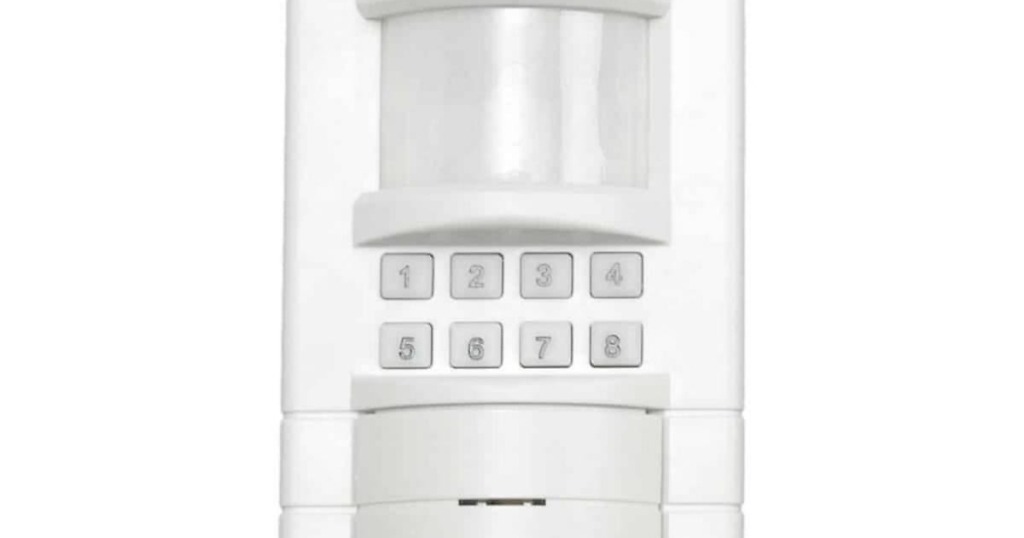

I'm looking for a specific (but cheap?!) motion alarm for inside my garage......however I don't want it immediatly start screaming 120 db as soon as I walk in the door.....I want it to beep of something to give me time to shut it off
but if a burgler comes in, he won't know how to shut it off in the 5-10 seconds and THEN it will scream
something like this, but with a delay?
thanks!

I dont know about cheap but every keypad type alarm I have seen has a delay so you can turn it off. It is usually adjustable. I think that is what you will need. You walk in and it senses you and starts counting down until you enter your pass code. If you dont enter your code in time it goes off.
Something like this but I dont know if I would trust a $15 one :)

A cheap DIY unmonitored alarm system could solve your problem, but you could also have a motion sensor or multiple motion sensors wired in parallel trigger and power on an adjustable timer relay with a normally closed and normally open contact and then wire a low dB "beeper alarm" to the NC relay and your horn alarm to the NO relay.
Most timer relays I've worked with get signal / trigger voltage to the timer, which then engages the timer delay to count down before closing the NO contact, but once the timer is triggered, do not reset the contact until signal has been lost, thus the alarm would continue to sound until the circuit was "disarmed" / reset.
The relay and circuit for the the low dB "beeper alarm" and horn alarm would not be powered until one or more of the motion sensors were triggered, at which time the timer relay gets powered and provides power to the "beeper alarm". Once the set time period is reached, the relay closes, turning off power to the "beeper" and turning on power to the horn.
Your "alarm bypass" would basically be a switch (or a cheap keypad that once a code is entered opens (disarms) / closes (arms) its own relay which acts as the switch) which disables / enables power to the timer relay.
