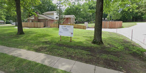

This "house" is down the street from my first house. Looks like a typical 60s/70s suburban residence on a big corner lot, right?
Nice privacy fence with a huge driveway in the back.
Check out the sign, normally the site is pretty incognito, but the city is advertising that they're currently redoing the facility. It's a wastewater pumping station in the middle of a suburban neighborhood.

Your comment kinda reminds me of this house, which looks like a normal residence on the outside. Someone built a datacenter.
Things are definitely easier (here) outside the city limits.. Pretty much wild west, which is great if you're into the shop thing.
