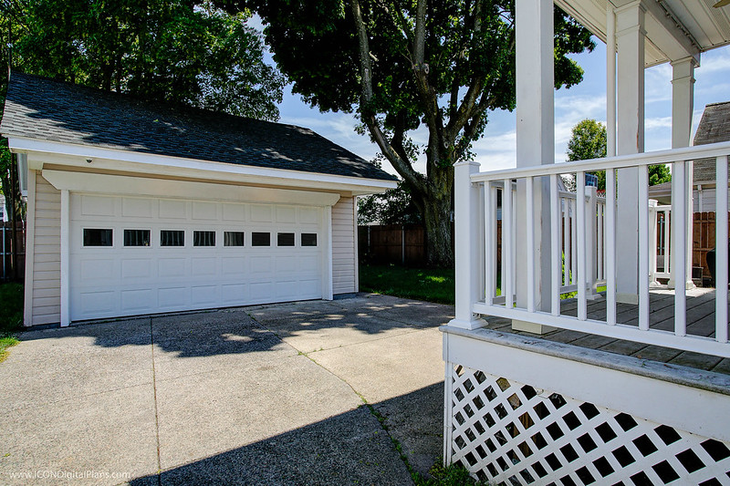

Our Old Garage:
The nightmare single wide driveway (couldn't open a car door without hitting the chimney or fence)

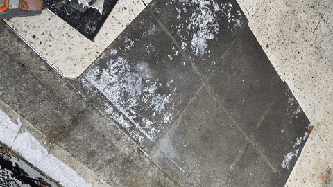

alright, tried a couple of methods on a few different tiles this afternoon during lunch. figured I would find the best way to proceed with the next 503 tiles so that I am still scraping on my hands and knees this time next year. due to how much glue gets left on the floor from these tiles, I have found that Goof-off does a good job of lifting the adhesive, but it does need to be scraped off of the concrete as it gums up in clumps. This glue is brutal if it gets on your hands, so I highly recommend gloves in order to proceed.
6 Tiles in, and I can tell this is going to be a challenge. each tile tears up with relative ease, but it tears due to the age. I'll try a scraper on an extension to see if I can lift them from a stool or something.
Process currently involves skimming the goof-off over the concrete, letting it sit for a couple of minutes, and scraping, degreasing, and washing off with a hose. I think I can get a good assembly line working for this where I will lift a few while solution is soaking on another grouping of exposed cement, and I can obviously degrease and hose off in larger sections to save time. My wife is already shaking her head on this one, but I have her support as long as she ends up with a bay!
Underneath the tile there was some signs of previous paint work, I hope that if the deep clean and etch don't take this up, it will be bonded enough to not create problems with the epoxy.

Making quick work of this floor today, but the weather has not been on my side. Hoping to see a break in the clouds / rain later on today so that I can move more stuff outside.
Within about an hour I knocked out abut 35% of the tiles with a large floor scraper. Not bad timing, and I'm not feeling much fatigue in my hands which is nice. Some of the tiles come up quick while others just chip and splinter.
I have a few sets of wheels to unload this weekend!
It looks like the floor was dealing with some heavy soiling, I am sure partly from all the new England winter salts. I'll be looking forward to taking a lot of this up and getting a uniform color down on the floor.

Have at that with a grinder and then hit it with a flood coat of penetrating sealer and you will be good to go. I would 1000% advise against epoxy based on what I am seeing.

Appreciate the recommendation. I might just take that advice, and stick with painting the cement around the edge black to help blend the transition.
Feeling a good burn as I plow past the 50%
266 tiles down, but overall pleased to find the floor crack free so far.
This corner must have had spilled paint or some white chemical trapped under the tile. It was soaked, and tracked around the garage and part of the driveway on my shoe.

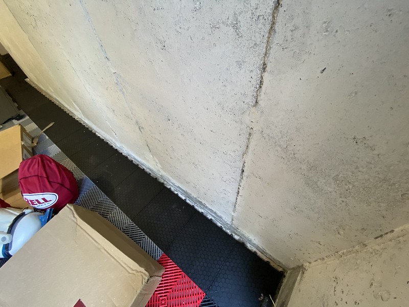

Took a break from the tile remove to turn my attention towards assessing the walls and ceiling.
The previous owner had performed an energy audit on the home which was awesome to have done, however in a number of areas they went a bit excessive with the spray foam. My garage door supports look like they have fungus or coral growth all over them, so I did a little bit of clean up.
I'll clean them up a bit more and probably seal them up with some joint compound before I paint the ceiling.

Hit a patch of good luck today. Got the adhesive off the floor and after some quick investigation i discovered that the existing concrete floor had a sealant on it already. I think that explains why the “painted” finish was lifted from the surface, and why it was coming up so quickly when I applied the Adhesive remover.
So with the dumpster here, and the need make progress, I started consolidated some boxes by throwing some of the racedeck flooring down.
Which went down very quickly.... a little too quickly. This stuff is borderline therapeutic.

Unsure what to do with the sides here. it’s only about an inch to the wall, which sees like a huge waist of tiles, but we’ll see if it starts to bother me.
