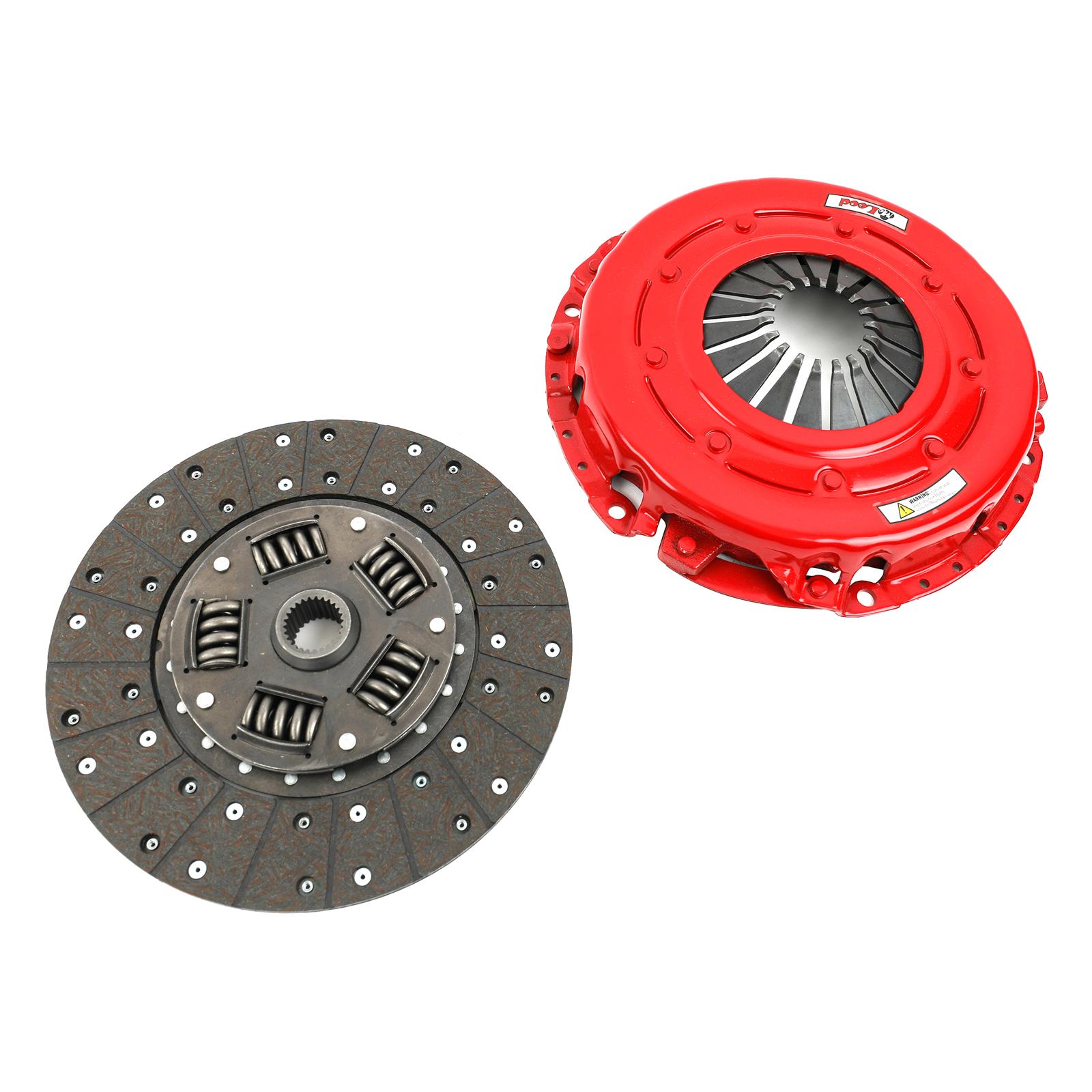

It's been awhile and I would have to look at exactly what clutch it is but I know it's a McLoed.
I believe this one 75025. . . . . 10.5" 26 spline 1 1/8" shaft
I don't want to completely wring the hell out of this thing, it's still running the stock factory roller block. Allow though it's half filled with Hard-Blok. I try to be conservative and finally getting it worked out, I don't want to break it just yet. I've already BTDT with a split block. If you were ever at The Corral.net, I had a thread, "My Carnage, my split block."
