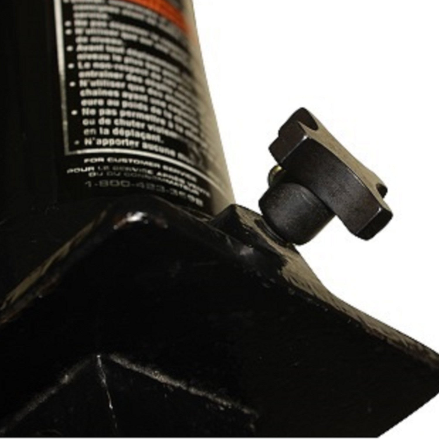

Being it's a metric size or NPT that I don't have, I went simple. Cleaning the paint off and clamping it with a bar clamp.
A little tacking and ready for some clean up.
The bolt is 5/16" and will get a jam nut and some loctite. I'm not sure how well it will work but we're going to try it. I will still order a replacement release valve...or two.
SilverJimmy
Apr 14, 2012
1,777
Prescott/Flagstaff, AZ
Have you seen these?
I have a couple, they’re really nice and not a bunch of loot.
Saw them and prompted me to think about making one...saw the Amazon one when looking for release valves and just said to myself, try it.
