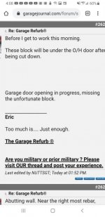

I did the man door and O/H door opening the same way. A piece of rebar in each one and filled to 5-6 " below the opening. When the floor is poured, this will help tie it all together.
Driving by, this is what you'd see yesterday. Block cores filled under openings, 3 cores filled at opening, all cores for J-bolts and the cores filled which had rebar tied to the footer filled.
