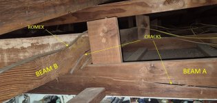

The pics below show the basic issues. "BEAM A" runs across the garage "side-to-side" and has 2 x 4 "nailers" (not sure that's the right term) for the ceiling laid flat and attached at 24" intervals. "BEAM B" runs lengthwise through the garage. Beam B sits on top of BEAM A and is joined via nailed vertical short piece of 2 x 6. I "think" BEAM B is acting as a collar tie for the rafter it is nailed to, but there is a dizzying array of beams up there and I'm not clear of the the intent of all of them.
I'm not sure when or how the damage was done. We did some extensive remodeling about 10 years ago and I had two 8' doors replaced by a single 16' door - requiring the installation of a LVL header beam over the door. Moving/jacking for that to get done may have been when the damage happened.
I am planning to repair BEAM A by sistering a new beam in as below:
1 - Jack up under the damage with bottle jack on a 4 x 4 to get it high enough, with a slab of lumber to spread the load (I don't think it will take much force - needs to come up an inch or two I think).
2 - Trim the 2 x 4 nailers 1.5" back on one side of the beam to make room for a new beam.
3 - Cut a new 2 x 6 beam long enough to be at least 2' on either side of the damage. Pre-drill it 1/4" for 5/16" lag bolts. Maybe 4 bolts either side and 4 in the cracked area = 12 total?
4 - Shoot high strength construction adhesive into the crack and onto the new beam. Clamp the new beam in place.
5 - Drive lag bolts through the new beam and into the broken one
6 - Attach the 2 x 4 nailers to the new beam by toe-nailing or similar.
I would basically do something similar to repair BEAM A. Then I'd be back at the original starting point with drywall repairs.
Any comments, corrections, concerns?

Isn't beam A parallel to the roof rafters? If so A is the rafter tie, resisting rafter thrust. B is a strong back intended to support the As.
Is there sagging elsewhere? If not, I'll offer a guess that this point was loaded and cracked the beams, and your fixes will be fine. If, on the other hand, the entire structure is under designed, it may not be. I wondered if the collar ties - ceiling rafters - were not designed for the weight of the ceiling. A common occurrence.
I think for fixing the cracks I'd plate both sides with 3/4 ply gussets. 4' long would be fine cut a notch for the 2x4 blocking and other obstructions, and let them be an inch or so taller than the rafter they are repairing. Glue and structural screws.

I think the cracks in beam "B" are just from the absolutely lousy grain pattern. That probably should never been used in the first place. Crack in "A" might be some of the same. Your plan of attack seems fine.
I cant tell from your picture exactly what beam "B" does ? It might be fine just left alone.

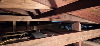

I really can't tell how that attic is framed, but from what I can see it appears to have been modified. Likely what caused the issue.
Pic from outside to show roof relative to door?
No hatch into attic I take it?

The short vertical pieces of 2 x 6 were used to tie the "B" beams to the "A" beams with nails. They are random lengths cut from drops/scraps and don't connect to anything else.
It is very difficult to get a photo that shows the whole situation clearly due to the low headroom.
As said, we did a remodel about 10 years ago and an LVL beam was put in above the 16' door. A structural engineer designed it and made drawings for how to install it and tie it in. He had no comments about the existing framing.

The 2x6 lumber on edge is NOT a beam.
Beams are big and beefy and typically have other framing members (like floor or ceiling joists) laid on edge on top of them.
If they go from wall top plate to the opposite wall top plate, then they are ceiling joists. Probably what you are calling 'Beam A'.
What you are calling 'Beam B' is probably a "strong back" on top of the ceiling joists (what you called 'Beam A').
Collar ties connect the opposing roof rafters together, usually about 1/3 of the way down from the roof ridge. You don't have collar ties, all that framing and nailers are planer with the wall top plates and drywall as far as I can see from your few pictures.
The 2x4 that are flat and connected to the ceiling joists are nailers for the drywall.

Without more pictures showing the framing better all around and some actual dimensions of the garage space, we are all just guessing here.
1950's garage I'm guessing that it would usually have had an annoying vertical metal post or two or three running down the middle of the garage from front to back (garage door is either the front or the back) holding up a beam that ran fully from front to back that would have been holding up the 2x6's that you labeled as 'Beam A'. Sometime in the past, someone MAY have removed those metal post(s) because they were annoying and caused some door dings.
The fix is to first look more closely at the existing framing and try to figure out WHY those 2x6's cracked.
Could just be the lumber cracked over time from drying, could be something was overloaded and cracked, could be something sagged and the 2x6's cracked, could be something was changed and caused sagging or overloaded conditions, could be some combination of those.

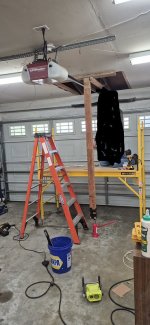

I bought materials on Friday night. I looked at Fir lumber for repairs but it felt very light. I opted for SYP 2x6x8' for the repair beams.
I got a friend and neighbor to help me. We cleaned out some space and set up a scaffold and set a jack up in the damaged area under Beam A. We screwed a 2x6 spreader under the beam and screwed a 4x4 (actually two 2x4s scabbed together) to the spreader as a lift post. We used an 8 ton HF bottle jack. We set up a laser level and found, to no one's surprise, that Beam A was sagging more than 2" at the center. We played with jacking to close the gap in the crack area of Beam A vs. "level" vs. matching the sag of the other cousins of Beam A.
We marked the level we wanted to put Beam A at and pre-drilled 3/8" holes into a new 2x6x8' repair board. We trimmed 1.5" from the 2x4 flat-laid nailers attached to Beam A to make room for the repair board. We removed a second sheet of drywall to get access to make the repairs. We then buttered the repair board with Titebond III adhesive, clamped it in place and screwed it in a few places with GRK screws to hold it. We match-drilled 3/8 holes into Beam to the holes in the repair board and installed the repair board with 3/8 thru-bolts. I used two 3/8 fender washers at each end (4 per bolt total) to help distribute the bolt load. The bolts are on 16 to 24 inch centers to miss other obstructions, and staggered side-to-side. I put loctite on the nuts just to help hold them if they got loose due to shrinkage or whatever. Hey - can't hurt and might help. Once it was all together, we added some more GRK screws just for good measure.
Beam B was pretty much cracked all the way through and the access was better (but also worse in that it had to be done from in the attic). We decided to put repair boards on both sides of it. We had to get longer bolts and a long drill bit to do that. I also added hurricane ties to tie Beam B to Beam A.
Photos are below:

2 - Jack set up
3 - Beams with repairs well along.
