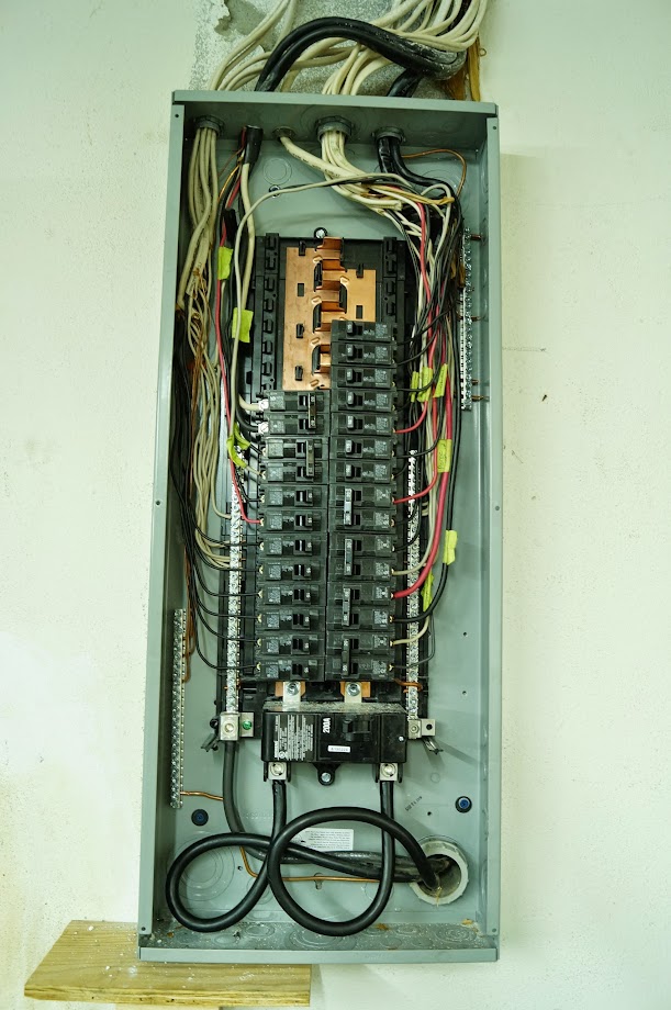

Hey guys, I have some questions about installing a sub-panel for my garage at the new house. It's an older house (built in '82) and all the breakers are in use in the main panel. So I'm definitely in need of a sub panel. Here's what I want to be able to run off this panel.
  1. 220v - Compressor
  2. 220v - Welder
  3. 220v - Scissor Lift
  4. 110v - Power Strip at bench
  5. 110v - Circuit for 2 extra outlets
I think a 100 amp panel will do this for me, but I'm no expert. The most that would be running at the same time would be the compressor and the welder.
Right now I have a little 110v welder so the extra outlets I want to add will need to support it's draw.
Here's the current panel. I need to know how I should get the power to the other panel and what wire to use.
And this is the current setup around it. So suggestions on mounting it would be appreciated also. If I have to move some stuff around I can do that as nothing is bolted down yet.
I'm pretty comfortable working around the wires, and would rather do this myself, so thanks for your input.

Are you sure the service to your house is large enough? Legally you can only have a certain amount of circuits for a given service even if you won't be using all of the circuits at once. Sometimes you need to add a sub panel to add a few extra things but you seem to want to add quite a bit of capacity and I have the feeling your service might not be enough.
Otherwise all you'd need is a 100A double-pole breaker and I would install that breaker at the very top of the box to keep the resistance as low as possible (which may bring you above 100A for that panel and thus require more than just the 100A breaker). You would obviously need to move one of the existing circuits to the new box as well to make room in the old. But for a 100A breaker, I would probably want to have a quality panel like Square D QO. I'm not good enough to identify your panel based on sight (well, the label says Sylvania so maybe they made the panel) but hopefully it's quality. You don't want to have a crappy Federal Pacific panel already known for catching on fire and then make things even riskier by putting a 100A breaker in it.
Check out this load calculation spreadsheet and fill it out and make sure you have enough capacity: http://www.electrical-knowhow.com/2012/01/residential-load-calculation.html
If you don't have enough capacity - and I can nearly guarantee you that you don't - just replace the entire panel with a 200A or 225A Square D QO panel. Get one with 40 spaces or more. You will need to have an electrician upgrade the meter and possibly the wire if they can't handle 200A. Or if you want, you could take the existing panel and set that up in the garage as a sub-panel from whatever new panel you buy. Again I would get something quality because the breaker you'd use from the main panel to go into the sub panel would be so large that quality of your panel is REALLY going to matter.

I would pony up for a new panel, adding more spaces, as you already have the 200 amp service in place. You will need to have the meter pulled and/or likely a permit and inspection, depending on the local laws.
The others will get you what you want, but still using an old panel and having to set a subpanel.
jvitez
Nov 30, 2009
2,429
Big Sky Country, Canada
Please do a proper load calc! Everything else is just guesswork.
To calculate your subpanel load, write down the WATTAGE of every appliance, light, heater, etc you plan on having in the shop. Now do some thinking about you'll use the shop. Think about what you could ever pssible have on using electricity at the same time in any possible circumstance. For example, compressor happens to turn on, welder is going, lights are on, electric heater is on, battery charger is plugged in, you get the picture. Add up the WATTAGE, not amperage of everything that could be on at the same time. Divide this total wattage by 240. That's the minimum amperage of subpanel that you'll need.
But you should do a load calc for your house as it currently sits, AND add the shop equipment load. Are you over 200 amps in total calculated load for the house+shop? I doubt it unless you have an electric furnace/range/water heater. But please do some simple math and a proper NEC load calc. Now your planning with facts, not wild-assed guesswork.
If your new total load is under 200 amps, the best would be to get a brand new 40 circuit 200 amp main breaker panel installed. You'll future proof any added circuits you could think of in your house, and you can feed anything in the shop off of one panel with no worries about overloading a subpanel. There's nothing wrong with adding a subpanel to your existing main panel though, as long as you can still get breakers for it.

Bringing this one back from the dead guys.

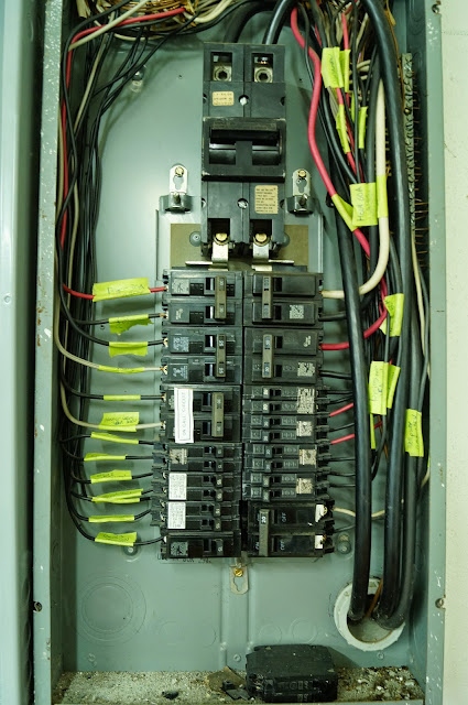

I decided to purchase the new breaker box and I'm pretty dead set on installing it myself, but wanted to ask an experts opinion first before I went cutting an extra hole in my new breaker box.
I've labeled the wires in my old box like so.
and I've mocked up the height of the box like so,
the top breakers should just be under 6'7" which as I understand it is the max height for them. But as you can see here, the hole where the conduit from outside comes in is just a little higher than I would want. At this point I just want to cut a hole about 3 inches higher than the standard punch out, you can just make out the pencil marks I made on the box.
I guess my question for the experts is, is this against code in some weird way. I couldn't find anything saying it was.

Nope. But thats gonna be a real B*tch to bend the wire like that with the main on the bottom. I wouldn't do it like that! I dont even see how u would make that bend. Can u change the position of the conduit so its lower? Also, is that feeder 3- or 4-wire? Looks like 3-wire. If it is and because youre changing out the panel, u are required to bring it to current code which means 4-wire and pulling an EGC to the panel as well as unbonding the neutral bar(i see the green ground bonding screw)...

You could put that hole where you want and bend the wires down to the bottom of panel and then back up,so they would be in a u shape. If that's a sub panel you need to do what wyliediesels says but I think you ok since it looks like your main panel. Personally I would use the prestamped knockout and not worry about the height of the top breakers,since it's usually for the main breaker they worry about the height.

Nope. But that's gonna be a real B*tch to bend the wire like that with the main on the bottom. I wouldn't do it like that! I dont even see how u would make that bend. Can u change the position of the conduit so its lower? Also, is that feeder 3- or 4-wire? Looks like 3-wire. If it is and because you're changing out the panel, u are required to bring it to current code which means 4-wire and pulling an EGC to the panel as well as unbonding the neutral bar(i see the green ground bonding screw)...
There is a ground wire that comes in from the grounding rod (a true grounding rod, not water pipe) outside and it's connected to the neutral/ground bars in the old panel. So if I'm understanding you correctly. In the new panel I'll need to un-bond the neutral from the case, and just separate all my neutrals and grounds when installing the new panel to bring it up to code?
Oh and yes this is the main panel not a sub panel going in.
That was my plan, either a U or clover bend then cut them down to length. Ah okay thanks for clearing up the breaker height issue. I may just use the pre-punched knockout then.

It's done! Woohoo! :bounce:
I got the new panel installed tonight, took me about 3 hours which is 2 hours faster than I thought it would. I had a little trickiness with some of the wires not wanting to reach and a real electrician would probably have been able to make it a little tidier, but I'm happy with the result and the fact that I can now wire up my compressor and new garage outlets.
I went with wylies suggestion and used the standard knockout at the bottom. I'll cover the wires back up and the top another day.
Hot wires! Capped on the end and wrapped with electrical tape.
Spaghetti! Or tree roots.
New panel in and all wired up.
Lots of space left for expansion.
Thanks for your help guys and gals!
Project total:
Copper bus 40 slot load center - $130
All new breakers - $288
Labor costs - FREE!
So that's a total of $418 spent. Compared to probably $1200-1500 if I had to have an electrician do it. I think that deserves a beer. :beer:

Copper bus Siemens, I like it. Good job on the installation even if it did come out a little tall.
Legally, you cannot bunch all of those wires in a single connector. I know it was done that way before, but the UL listing and the manufacturers instructions for each of those large clamps will define what can be put in them, and it isn't a bundle of 12/2 Romex.
However, sometimes you gotta do what you gotta do, and given how many thousands of panels are done that way in the country, I cannot fault you too much for doing it.
