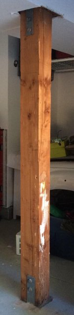

The attached pictures show a pillar / column that supports a second story, across the span of a three car garage. I have heard that the builder used green Doug fir and other construction methods that left our development with a lot of warped floors, joists, and columns. Just a little back ground if it matters to those in the know. This project is taking place just north of San Francisco about an hour.
The column is 1" out of plumb at half height. At some point either the builder or prior owner squared some timber around it to hang drywall. They cut 2x4s at angles to compensate for the warp, so the drywall was square and plumb.
I would like to replace the column with something of a smaller diameter, or leave the column in place if it's unnecessary and would cause potential for other issues by shifting the house that has settled together, if that makes sense. Any suggestions?

You can replace the column with something smaller, but it's going to be messy and expensive. A 4" steel column would take the load, but you'll need an engineer to design the new connection, jack the house up and temporarily support it, jack hammer out the post foundation, re-pour the foundation for the new column and attaching hardware, and then beg for your spouse's forgiveness (for a very long time) for the mess.
Does the post worry you in some way or do you just want a smaller one?

When a column is out of plumb there additional bending as well as compression forces that are imposed on the column. Eccentric loading can lead to instability and column failure. Imagine a column at a 30 deg angle; you can see that the entire system would want to translate sideways.
What probably happened is the framers made an error and the point of attachment of the column top was not directly over the center of the pad footing. Or vice versa, the concrete contractor misplaced the concrete pad. Or then again it could have been a design error.
It would not be too hard to replace this column with a smaller tube steel section. What you would need to provide your engineer is information on what is loading the column and the size of the pad footing below the column. He could also include the eccentric loading of the column in his column calculations.

I'd say your biggest issues are that you are in a seismic zone and that changing the column type means changing the connections/footer.
The design guidelines for wood assume that these members will shrink, bend, warp, etc. over time. Even though your 8X8 is out of plumb, there is a 7X7 (at least - probably larger if you want to do the trigonometry/geometry) area of material within it that is plumb to the gravity load and perfectly capable of holding up the load.
If it worries you, having an engineer bless what you have may be less effort/expense than a replacement.
If you are sagging up above, you might be better off shimming the top of the post, etc. It would be really difficult to get a new one in there and get it just perfect. A new post would probably need to be shimmed anyway.

Very nice reference...It looks like 1/2" although section 6-6 states that there is no standard, just a culmination of various manuals. This column is almost an inch out of plumb, so, it looks like I should probably replace it. It would be super cool to find some old timber and do something creative. Is jacking it up and sliding a replacement in there a "watch this moment" or does it seem as simple as I think it sounds[1]

For anyone that may search this thread in the future here's what I did:
picked up a kiln dried center cut dug fir
jacked up each side of overhead horizontal support beam with bottle jacks and 2x6s
raised up horizontal support beam just enough to get old post out
slid new post in top bracket
slid top bracket over along the overhead beam to get new post plum
lowered beam on new post
drilled holes in new post using pre existing footer support and beam support bracket holes as template
sealed with primer then top coat
surrounded footer bracket and top bracket (and bolt heads and nuts) with a 2x12, routed out the inside to cover over the hardware, silicone on the joints
finally stepped back and looked at the cracks in the old column
