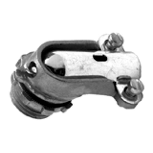

I hope I am wrong, but that BX cable looks like it is not properly attached? if all you did was pull the conductors through the hole on the bottom of the disposal you are looking for an education in 120V stimulation, or giving your insurance agent a reason to deny a fire claim. you want one of these if that is the case :
http://www.ideadigitalcontent.com/files/10992/PIC_801dc2.jpg

And it's hard to tell but I can't see a fitting for the AC cable at the switch.

now that you mention it... WTF!! there seem to be a pair of NM coming out of the same section of flex ( 3/4"?) conduit at the switch box. :)
