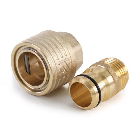

Exposed o-ring on the ELEY plug is a failure point. Compared to the captive o—ring in the socket which a better design.
You would not see an exposed o-ring seal on a quality air fitting.
