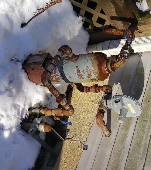

This is the setup going into my house. Do I need to do the same at the out bldg? What is the tank for? Can I install the new regulator in the out bldg? How can I check the pressure coming to the house? Do I need to know that to get the regulator?

If you are talking about measuring the pressure coming in to the house, you need a low pressure gauge (diaphragm gauge VS a bourdon operated gauge). The output of a regulator like that is typically 5-9" W.C.
Something like this one....
http://www.rsdtotalcontrol.com/assets/prod/575.pdf
In your picture, that regulator is mounted upside down. That (threaded) hole is a vent and should point down to keep out the rain and bugs. If you mount that new regulator inside the building, that vent hole needs to be piped outside. That is to take care of diaphragm failure or pressure relief from the regulator itself. Most regulators like that have an internal relief feature to take care of any over pressure down stream.
To size a regulator, you need inlet pressure, desired outlet pressure and the flow (BTU or CFH) That will allow you to select the correct orifice size for your load. If it is Nat Gas, it typically has a BTU content of 1000 per Cu.Ft. (from a gas utility)

Here it is right side up, didn't notice it wasn't until a further look.
Probably OK as is.

Go out to the Well to see if there is a pressure gauge. "Usually is!"
Tank like thing is probably a Condensate Trap. I haven't asked out there (Western New York) but usually New Gas Wells will have a lot of light ends that tend to drop out. Old guys used to wash their Oil field clothes in it because it would evaporate off the clothes on the clothes line.

so technically I could attach the pressure test to the pipe off of the tank?

That tank appears to be some sort of sediment or liquids trap.
If I'm looking at it right, all you have to do to incinerate your house is to open the quarter turn valve and throw a match at that 1" open pipe.
I'm leaving this thread before someone gets hurt.

The tank is called ( east coast slang, drip leg, drip pipe, sediment tank, solid or heavy tank, scrubber ). I heard them all used in my time.
The center top fitting should have an inner rod going downward the the bottom of the “tank”. The tanks can be any length ( into the ground ) as they can be made up on the field as needed.
You would just crack the blowoff valve and see if liquids or such come out and measure the volume. Minimum here is an annual check for all drip legs on the entire city grid. Wet gas can cause havoc with the appliances in the home. Worse case older standing pilots could go out, regulator could freeze up and lots of other concerns.
Normal the tank is buried to protect collected liquids from freezing and just the blowoff valve and pipe come to the surface in a small or large curb box or manhole .
That tank could be just a surface tank as well.
In your picture shown, it is unsafe. The blow valve exhaust pipe has to be capped.
Here we also would use a locking valve on the blowoff only and keep it locked closed along with the threaded cap in place.
The regulator has a vent, that’s the threaded opening we can see in the pic. Normally here it is required to have a screen, we have street 90 degree elbows with a metal mesh, screen over them for just this task. This keeps bugs, insects and critters from making a home. Again per code.
Based on your snow loads, code sets the height and ultimate location of the vent as well to keep snow clear, you will see that regulator vent piped upward or away as needed.
I would have piping and such that looked at by a professional for sure.
