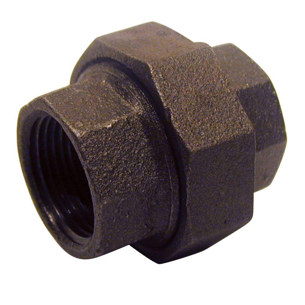

I had a home energy audit performed. They found a slight leak of natural gas by the furnace. Right at the union pipes. The furnace is at least 10 years old and been serviced more than a few times. No one ever noticed the leak. What thread sealant is best?

You said it's at a union? Does it look like this?
If so, that it sealed by an interference between the tapers of the union ends, not by the threads. It might just need to be tightened, or taken apart and the ends cleaned up and re installed.

I had it apart. I applied some pipe dope with the ptfe? (Oatey). Reinstalled. I can faintly smell gas on either side. I bought a new union tonight figuring that may be the solution. I will go back tomorrow and get the yellow canister teflon tape and start from scratch. All of the older pipes look like they have the thicker pipe dope (whatever they used back when).
The union seals at the metal to metal interface, so the threads on the collar are not part of the seal, but it is possible for the pipe threads to be leaking. This is a job for...

Ok, so if it's leaking out the sides, then the NPT pipe threads may simply need to be tightened (unless it's a crack in the fitting, or the fitting turns out to be porous). However, if it is taken apart, it will need more dope to be applied.
If it is leaking out of the collar, it is leaking from the ground metal to metal seat of the union. This should not get pipe dope applied to it, but can be coated in grease or oil (Nylog comes to mind). More likely than not, it too just needs tightening, as cheap unions can take a surprising amount of force to seal.

I'm guessing the union isn't a good one. I can smell a hint of gas on either side of the threads. I've got everything pretty tight. I bought a new union, different sealant and I'll get some yellow tape and give it a whirl.

I had the same thing happen a few years ago. This is what was recommended:
Thanks for recommending this. Bought this and a new union. Definitely think it was a seating issue with the old union. Thoughts

To add to what Disney said: While you’re there with your tools and everything, you should undo both of the union halves from their respective pipes, apply pipe sealant to the male threads and retighten. Don’t forget to slide the large union nut onto the pipe first. Don’t overtighten. The sealant will seal it. Gas is like 0.5 psi.
Now, like Disney said, when you join the union together with the large nut, it’s the special metal surfaces on the two ends that seal, even if the pipes aren’t perfectly aligned. Don’t use sealant on the large nut. It won’t hurt, but those are not “pipe threads” and aren’t there to make a seal.
Another poster says a little sealant on the mating surfaces is good and that sounds like a good idea, even though it’s not needed, supposedly. Your leak was probably extremely small and harmless.

All the import fittings are hit and miss, especially unions.
Here's a real made in USA standard 150 union. Excellent machined surfaces with a brass beveled ring for seating.
