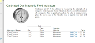

At work we measure residual magnetism on workpieces. We get our gauss meters from the R. B. Annie’s Company in Greencastle IN.
Excellent info. In my initial Googling I was coming up with lots of digital models but I don't need the max memory, data logging, etc. of a digital model and I'd much rather have something simple and we'll built.
May I ask, when checking for residual magnetism, at what distance from a part do you test? And what range model do you use (-10 to 10 Gauss, - 20 to 20, etc.)

We get our gauss meters from McMaster Carr.
I hadn't thought about McMaster but I should have. That looks a lot like the R. B. Annis recommended above. I've since found those and the Magnaflux models show up often in searches.
Sorry I didn’t see your question. Our process is influenced by magnetic fields as small as 1 gauss. We use +/-2 gauss meters directly on the workpiece. The company is R.B. Annis, stupid spellcheck
