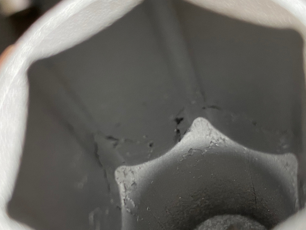

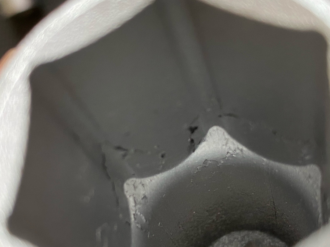

Hello everyone,
This is my first post and I found the forum in search of answers regarding Gedore...
So disappointed and have lost any trust in them... I have no idea if Gedore UK is doing to me or just the German manufacturer changed...
I have no idea how to post pictures here for you to see and will try to explain

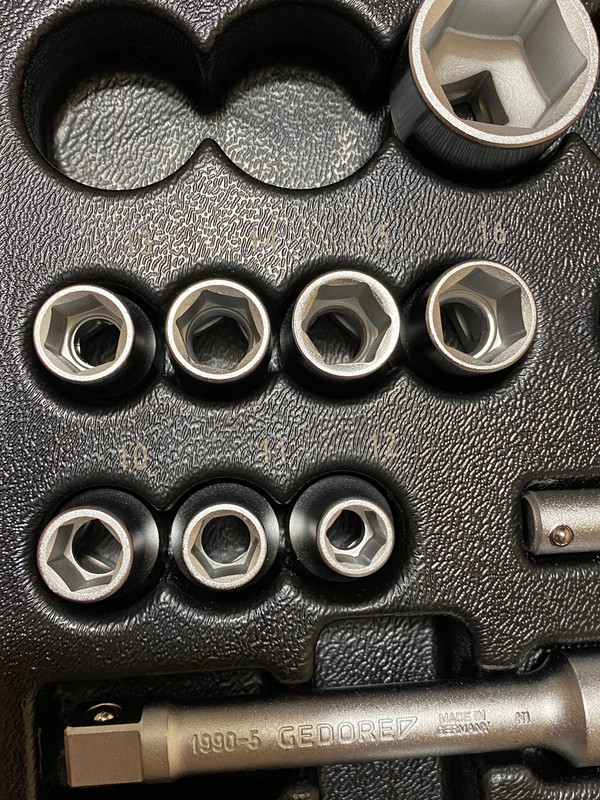

Big socket box from 10mm to 36mm 1/2” some 8 sockets are with easy to spot deep scars inside the 6 point hexagon... I wrote numerous email just to receive answers that is the way it is... 🙄
Spanner set 6mm to 32mm N7 three are with issues like they have been rusted and after that chromed and one of them looks like someone played with a grinder over it before coming...
Some of the sockets are without any symmetry of the hexagon feels like before manufacturing the sockets weren't centered...
Ind so on and so on... and everywhere is stamped Made in Germany 🇩🇪 🙄
Anyone with similar issues... I think to pack everything and returned where it comes from 🙄

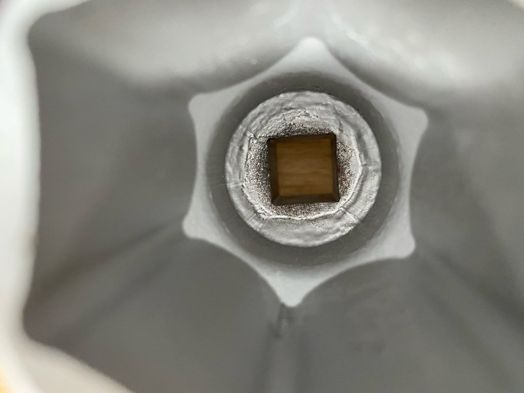

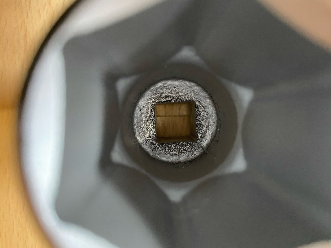

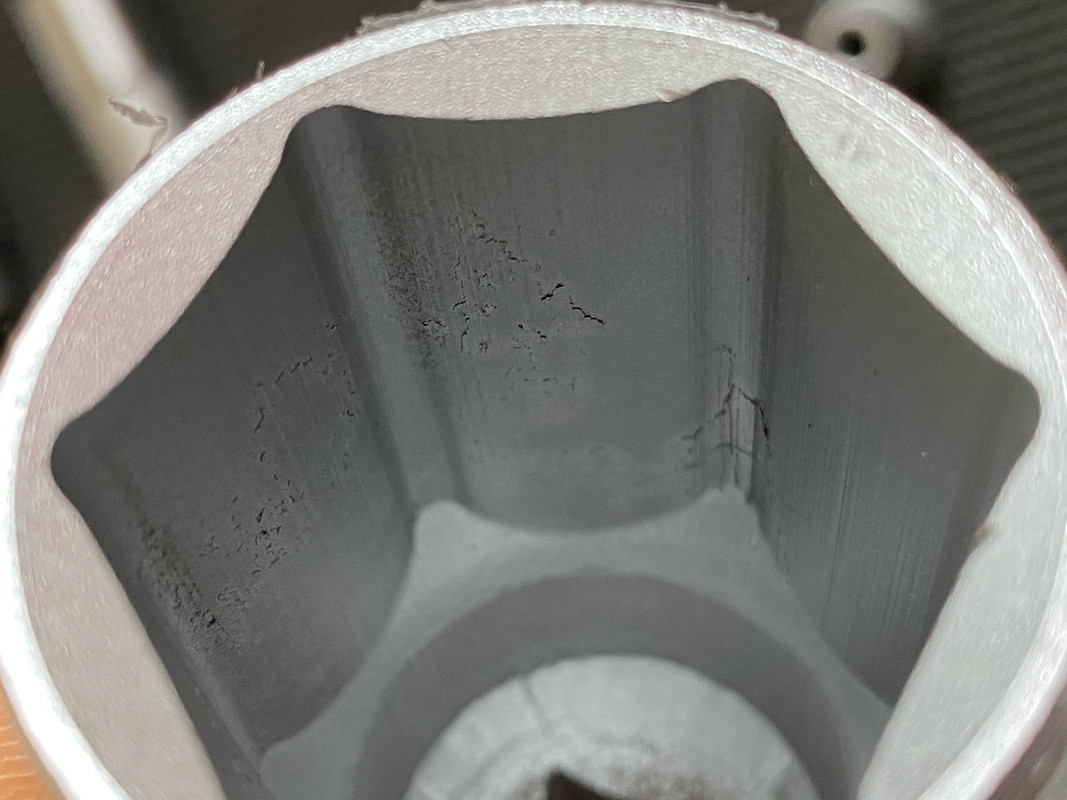

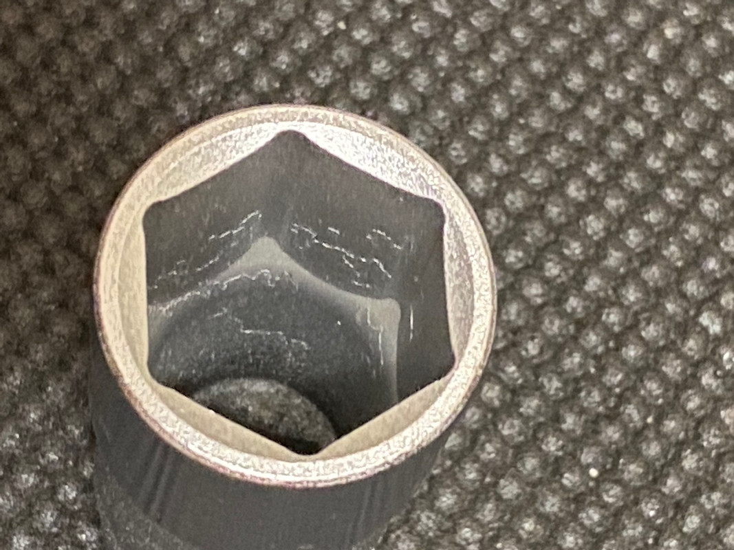

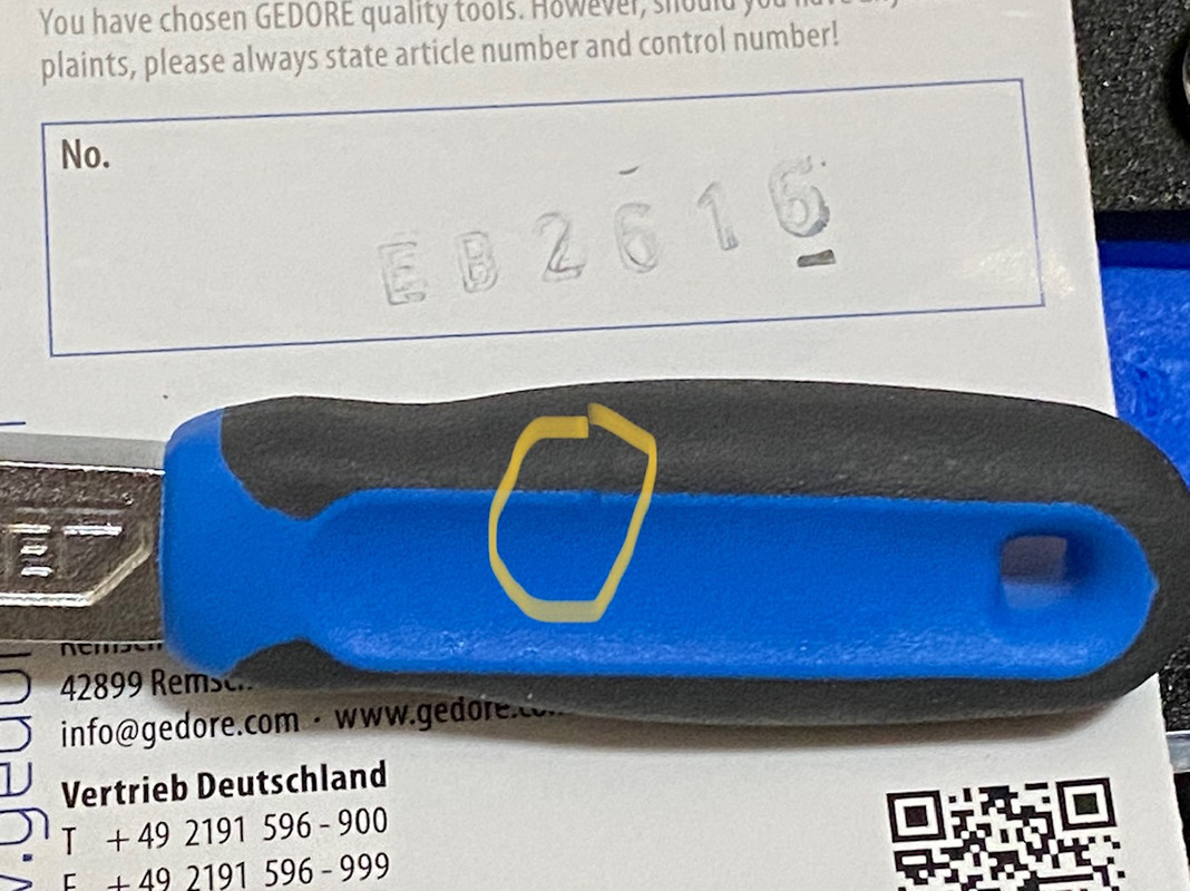

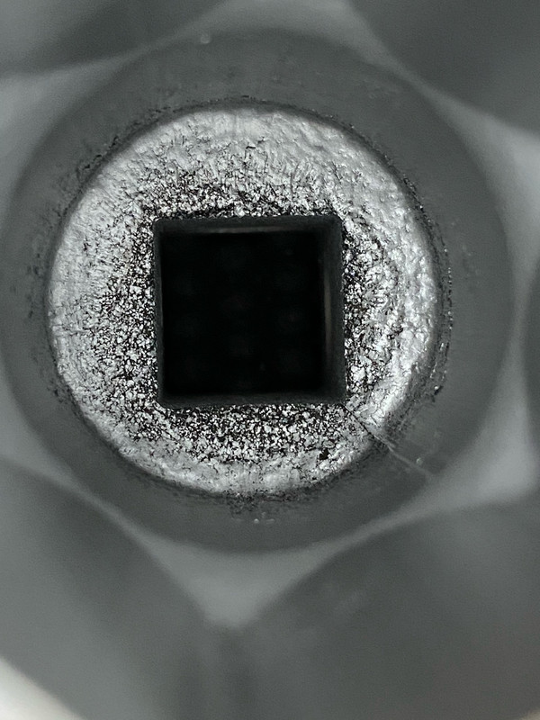

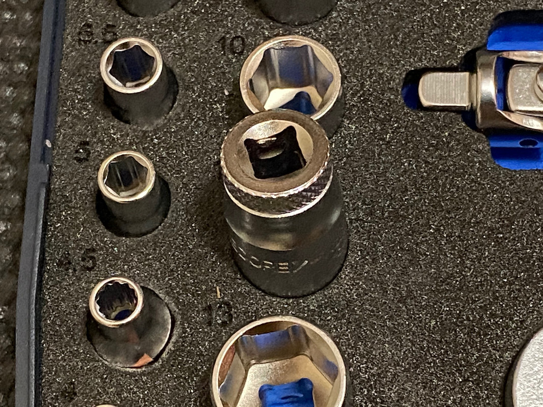

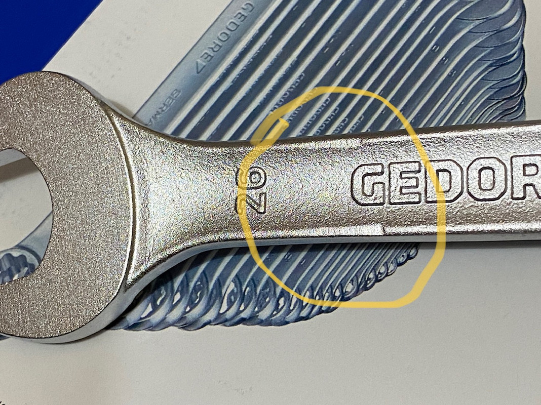

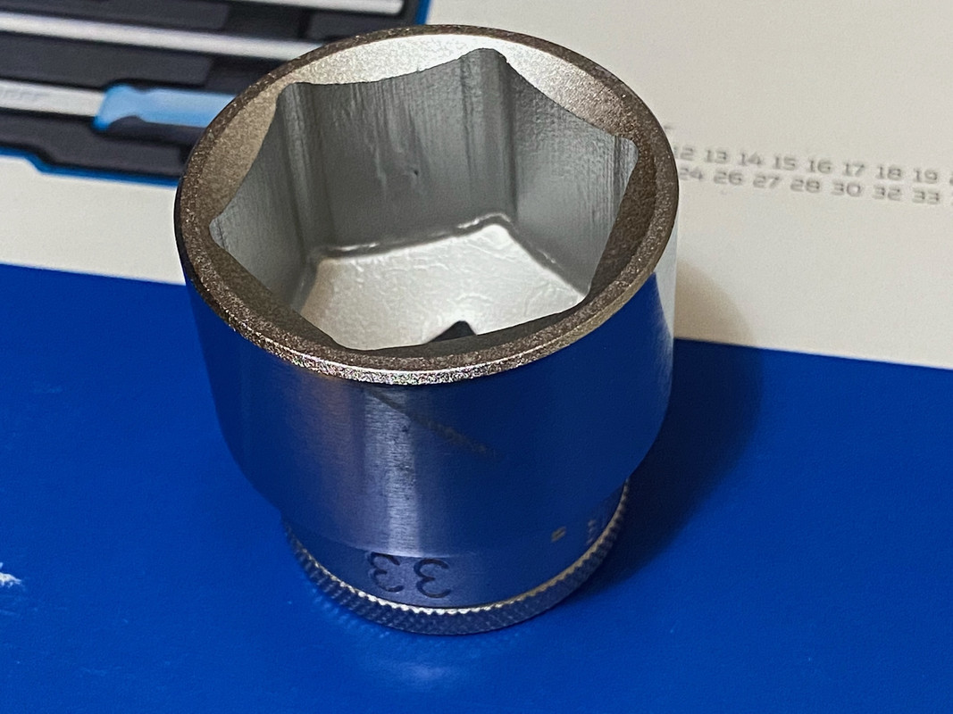

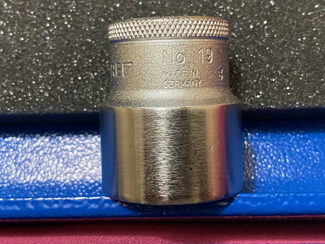

Well, it is not a microlens it is my phone... When you hold it you can see on the bottom is like rust... coming out. The basic symmetry is not present, the inside walls on most of the sockets are like they miss some of the manufacturing processes before the final one...

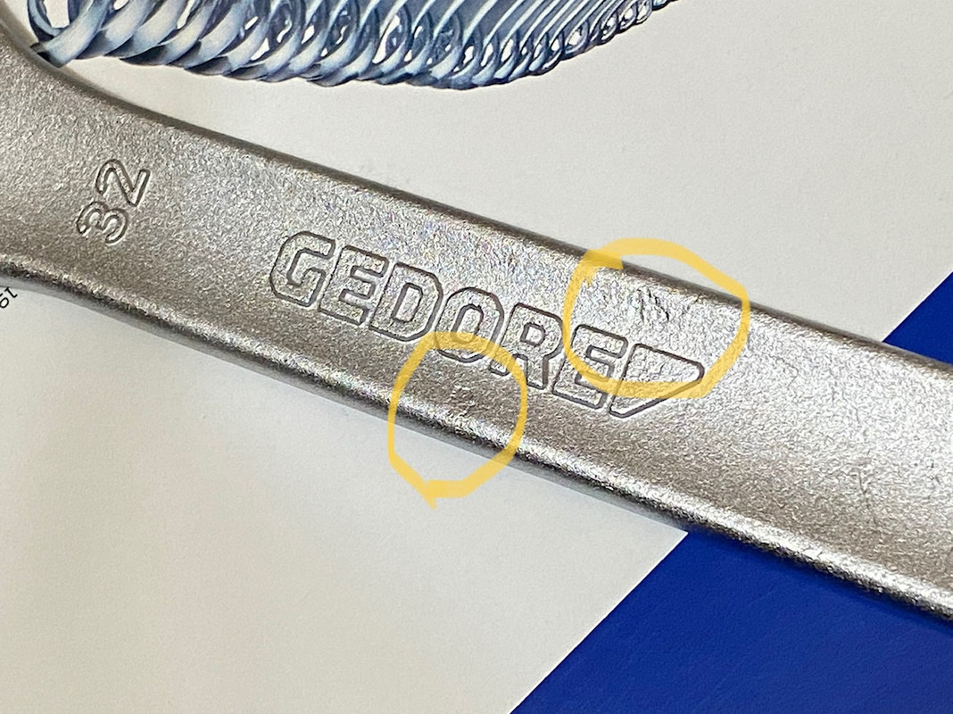

One of the spammers is with one side of the open-end is just treated half and is difficult to see it in the photo...
Pilling out the chrome you call it cosmetic... For brand new sockets and with such price...
To me, one thing is for sure Gedore is not anymore whatever was...
Finding sockets inside the set that do not belongs there... and so on...

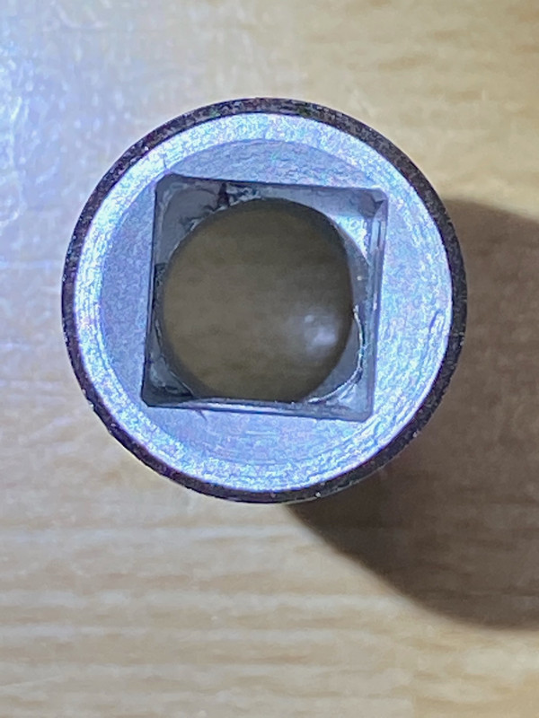

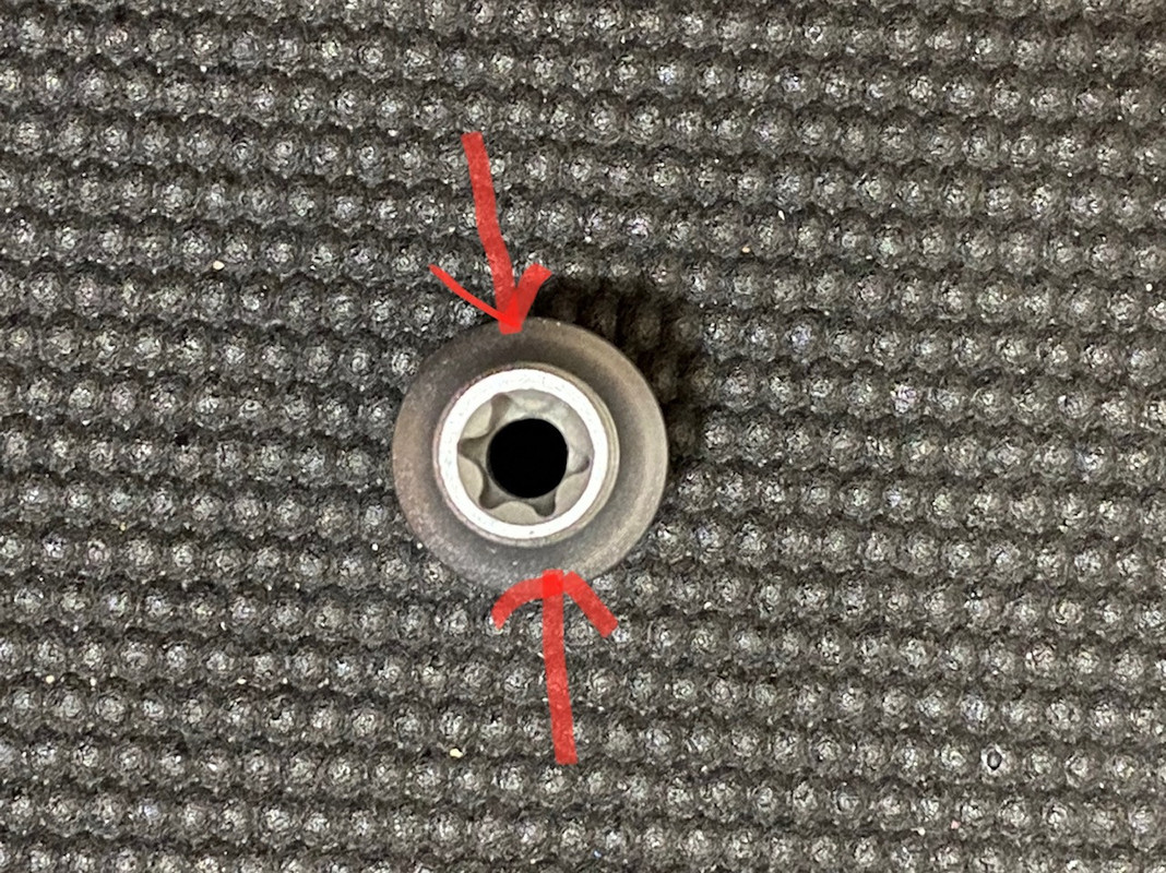

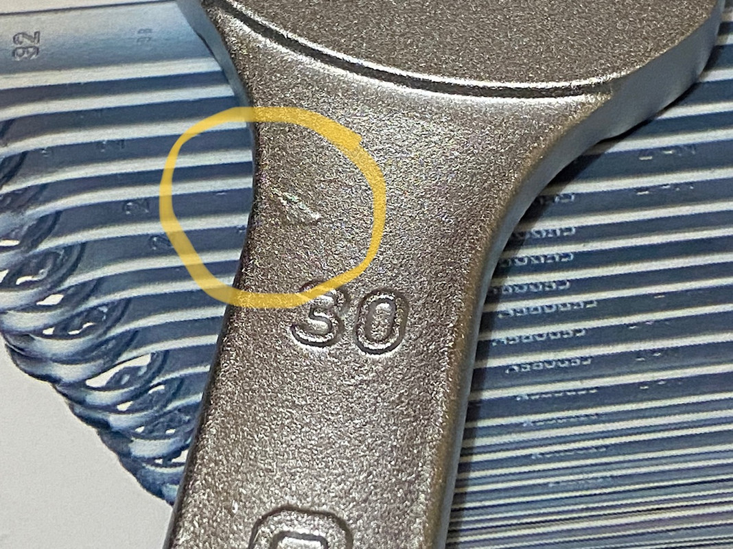

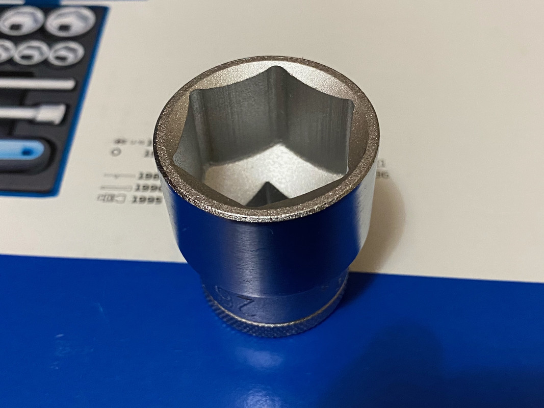

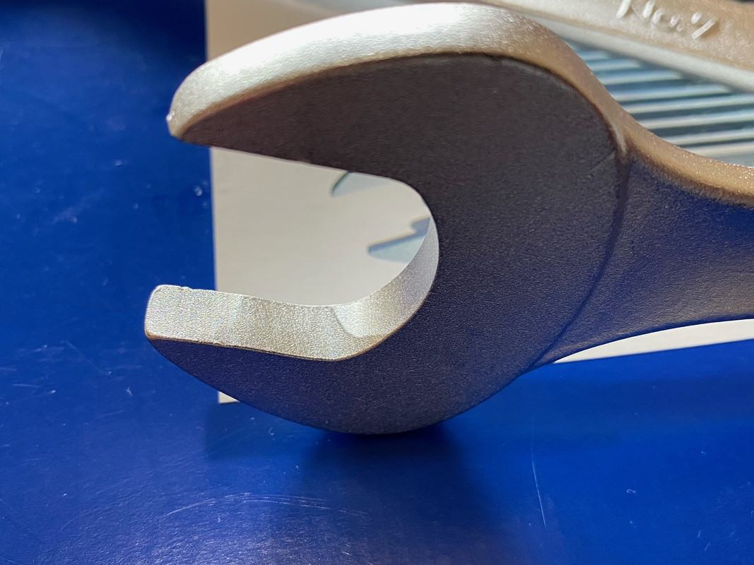

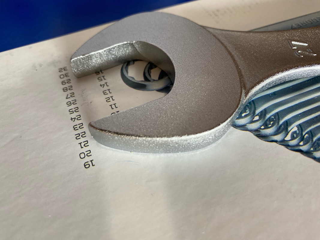

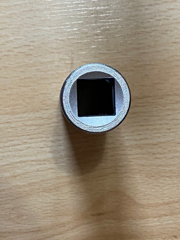

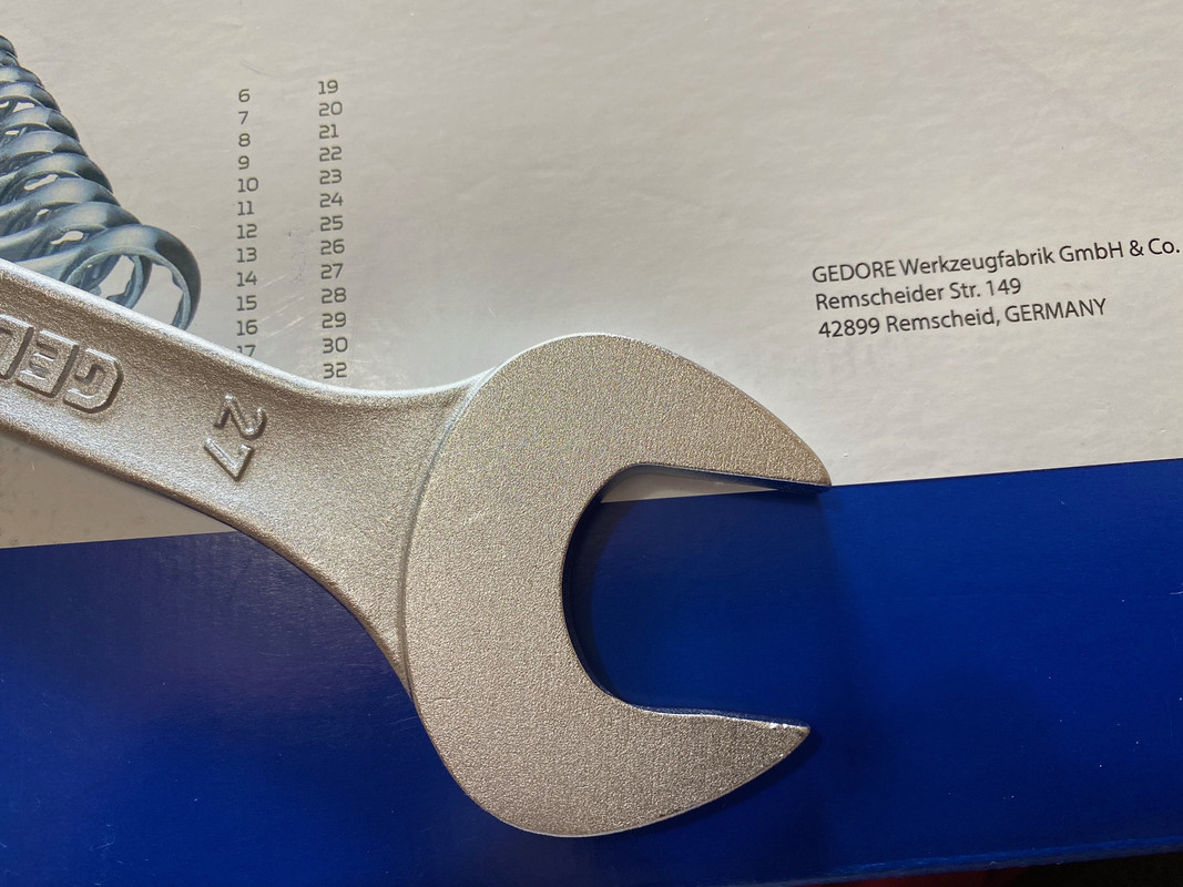

The grind marks on the 26 mm are bad. But the crooked jaw on the 27 is unacceptable. The flaws in the sockets and castings don't really bother me that much.
You're obviously unhappy though, so send it all back.

I wouldn’t worry about the finish, it’s a tool. But the off center broaching would have them being returned.
I would, flaking plating is a massive issue in a lot of industries .
I had a set of Koken sockets and snapon wrenches that flaked and chipped badly and beside splinter issue it was big issue if working on engines hydraulics etc and had be addressed ...

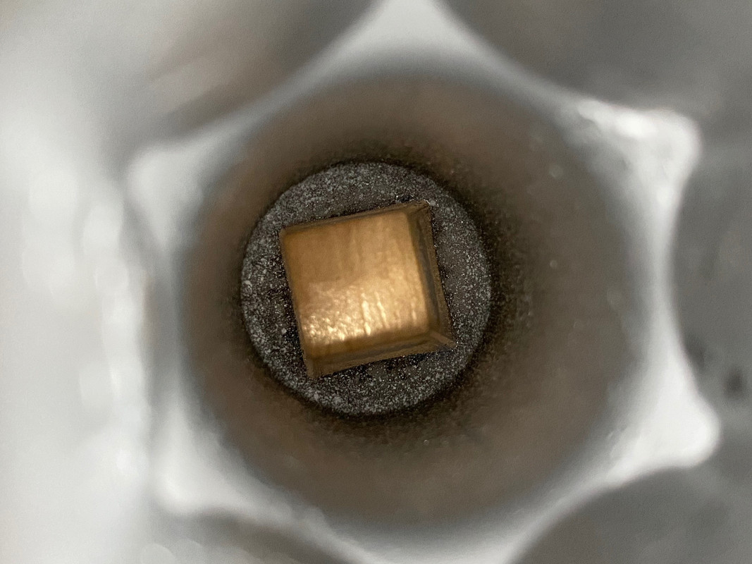

Macro mode means the camera is focusing extremely close.
Those are nice tools you bought. If you want show tools try Snap-on, Nepros, Ko-Ken, Proto/MAC etc.. They'll look great on display in a plexi-glass box. I suspect you'll be paying a fair bit more than what you paid for Gedore. Half the time my stuff is fixing a rotting wreck so a tiny divot in a socket wall or wrench beam wouldnt bother me. It actually fits with the rough blasted finish that Gedore applies. A socket being ten thou off on a broach also wouldnt effect anything. Most guys wouldnt notice what you're complaining about. Your OCD is just going off the charts. Sorry.
Thats not plating, thats paint and the broach isnt 100% clean. Not going to win the tool beauty contest but its absolutely fine.
American Locomotive
Jan 8, 2017
11,002
Rhode Island

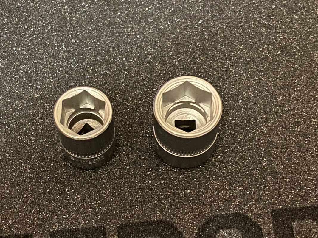

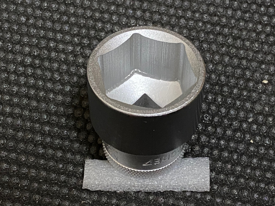

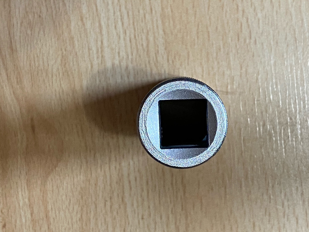

I agree with the others that the cosmetic blemishes (grind marks, small dents, chips, paint/finish flaking, etc..) are pretty normal for industrial tools, and should be expected honestly.
But the messed up broaching on the sockets and that wrench is not normal, and not acceptable.
That's way, way more than "ten thou". These are 1/2" drive sockets, so that drive end broach looks off centered by at least .030"-0.040", which is absolutely terrible and CAN theoretically cause issues, especially if you have long studs that protrude into the drive end slightly.
Not only that, but some of the sockets looked like the working end broach was off center as well. That can directly cause problems on recessed bolts in tight-clearance applications, where the socket moving in an eccentric pattern could cause it to bind in the hole.
I not referring purely to the internal broach but seems that finished so poorly with paint over some poor chrome and poor and broach finish and the alloy shows a lot of voids I wouldn't put much faith in plating around the hex edge .
I've got decades of experience working with german hand tools and gedore was never that great on plating durability .
stahlwille was one of best on durable plating, good ergonomic advantages and less glare from inspection lights with satin chrome and very hard wearing to point you can wear down plating through usage cycles rather than flake .
alloy stock, forging, broach tooling and general finishing is piss poor and way below what expect at that price point .
toptul, premier do better out of taiwan for 2 or 3 bucks a socket.
toptul or facom taiwan wrenches pretty decent too, gedore wrenches are well known for poor open ends and broaches can be rough from poor tooling .
My thoughts too. The wrenches are pretty bad there.

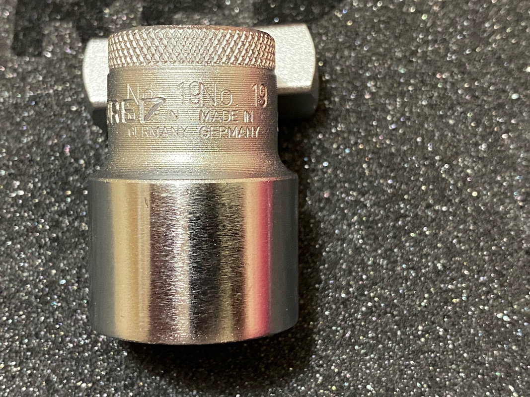

I see that one socket stamping was an overstrike too.
My question is how did one guy get so many new flawed tools? Are they selling seconds without telling people?

The wrench jaws are flawed and would cause me to return them. Most of the socket broaching is fine but not pretty; same **** comes up on other brands that silver paint their socket inners. The offset in the socket drive broaching post 15 pic 10 is **** though. Yippee, welcome to the economy where pushing product and letting end users do QC is a valid practice.
