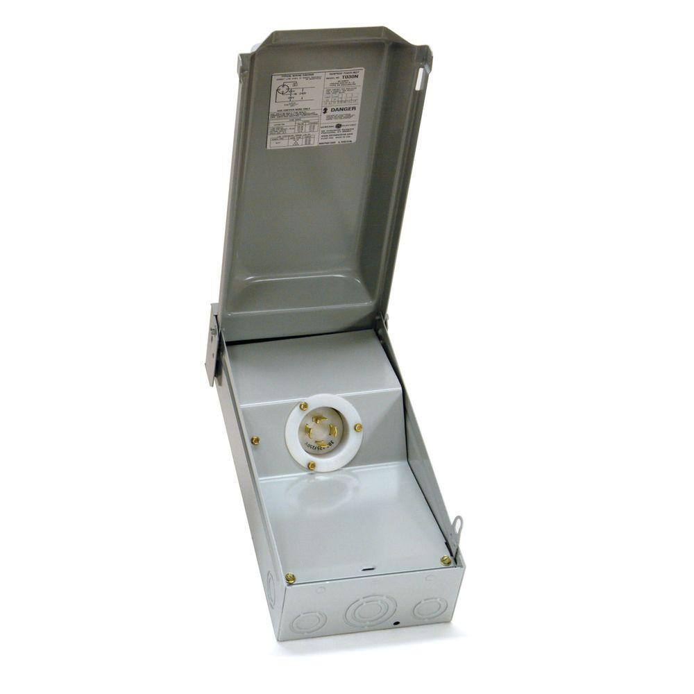

I have a 3500 working watt gen 120/240V, for emergency use.
Right now, even to keep the fridge going, I'd have to raise the stabilizer legs and roll it away from the wall just to plug in.
I'll have my electrician wire stuff in, but could I start with something like this, put in a cross-over switch and then just switch circuits on/off using the existing 200A circuit breaker?
I Oil furnace, well pump , water heater, central A/C (probably just use 1 windows a/c unit or portable heaters) Mainly want refrigeration and water.
Better ideas? Thanks.

That is incorrect, it's a 240 volt cord and connectors.
The cord will support 120v loads, 240v loads and 120/240v loads since it has L14-30 cap ends = 4 wire caps and cord.
Get a 30a power inlet box and add a 2pole 30a cb interlocked with the panel main cb.
This way you can manually select any load in the panel to operate under 30a total.

Isn't that what I typed? Zen said it was 120 only, I corrected that its 240, which by inference with the included neutral it will support both 240 and 120 volts. BTW, the referenced Item comes with a 30 amp inlet box. See post #1

Looks like a square D homeline.
Top right breaker needs to be moved, you have plenty of space. 30A or 50A goes in it's place. The homeline interlock kit will include a template, drills bits and bolts. It only allows the main OR the generator indeed breaker to be "on".
Then get a generator inlet sized to the breaker you added:
Connect the two with the appropriate 4 wires (individual wires need conduit, or watch the ratings on NM-B/UF-B).
Now in an outage flip the main "off", slide the interconnect, generator breaker "on", shut off large loads (as needed) and go fire up the generator.
This is very abbreviated

Sounds like you are headed toward an interlock and generator inlet as described in post #29 and #30. And that is a good plan.
A transfer switch is often a double throw device ahead of the main breaker. When that is the case, it becomes the first disconnect and you have to isolate ground and neutral in the panel. The old "main" panel becomes a subpanel. An automatic transfer switch is another case. A manual transfer switch might look like this:
