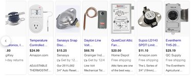

What would be the best type of thermostat, heat sensor type of switch for this?? From experimenting the highest temperature I have seen is 104 degrees, so thinking 110 shut down??
Industrially, the very best would be a thermocouple talking to a temperature transmitter with a digital milliamp switch if you want that tight of a dead band between set/reset. If you would prefer a much cheaper but wider gap between set/reset, some sort of capillary temperature switch with a range close to 110* would work. You would have to make sure it has both normally open and normally closed contacts as these switches are typically used to turn fans ON when hot, whereas you need stuff to turn OFF when hot.
Some of those snap discs might be interesting if you get the right range. Any of the others that are adjustable would take some trial and error testing to get the set point right. Be aware that most of these switches could have a significant hysteresis that would require cooling the switch 10 or even 30 degrees to reset.
Maybe a dial thermometer?
Thanks for the response. I will spend the evening sorting through the choices and see what I can come up with.

That snap switch is normally open and closes at temperature. I believe you need a normally closed shelf state that pops open at temperature, according to your unplugged test. I didn’t find anything that states a reset temperature or deadband , so it likely could be a significant number.
Buy several, try ‘em out, experiment!

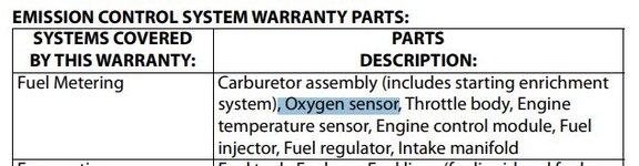

They added an 02 sensor, which is a pain, ...
The O2 sensor is so the EFI can correct the fuel mixture at different altitudes.
Segue - In the recreational inverter market, I am surprised that the only competition Honda has for this specific model is the Westinghouse iGen 2550.
EDIT : Champion now has a 2500W generator. Some models are dual fuel (gasoline and LP).
I can't believe how the internet messes things up, now how did CO detector morph into 02 sensor??

There are virtually thousands of thermal switches available. Pick a temperature, decide manual reset or automatic.
In the application I would use the manual reset, normally closed. You have to push a button to reset it after cool down. Can of cold liquid set on it cools it quickly but I digress. By manually reserving it makes you look why it tripping.
