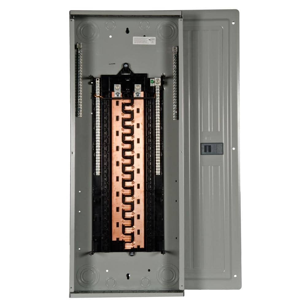

All major brands of panels sell tandems. Quick and easy to install (unless the box is already full of tandems).
Tandems will only install in panels that will accept them. Not all panels and not all spaces will let a tandem be installed. some have a notch in the buss, others like Square D QO and Eaton CH are a little different. A panel is listed only for so many circuits, it is a violation to exceed that number. I understand they make the "cheater" style tandems, but you should still not exceed the maximum circuit rating. Your newer panels will have it on the label if tandems are accepted.
theoldwizard1
Feb 22, 2011
43,489
SE MI
IANAE, but I have not run into any panels that will not accept SOME tandems. May be a limited number. Last time I needed to add tandems, the limit was 4 and that was exactly what I needed !
Terry D
Mar 25, 2015
2,202
St. Louis, MO.
Here are two 200 amp panels. The fist will not except tandems. 40 space - 40 circuit
The second will except tandems. 40 space - 60 circuit. The bottom 20 spaces will except them.
Norcal
Mar 16, 2008
13,781
Virtually the entire installed base of Cutler-Hammer/Eaton CH loadcenters, is not listed to accept twin breakers, they will plug in anywhere, but only a few are listed for their use, can easily tell when they are not.
