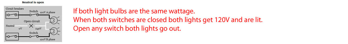

Not really weird. 120V loads are wired in series across the 240V lines with the loads on each side of the transformer in parallel. The neutral wire provides a bypass path for current flow to balance while keeping the voltage at the neutral junction constant. Without a neutral wire, the voltage of the neutral point moves toward the leg that’s most lightly loaded. If the loads are equal, everything works fine, but as soon as one side gets a heavier load the voltage on the other side goes up.
If you have not done the math it is very weird. the 500 Watt lamp will not light and the 5 Watt lamp will be super bright for a short time. 2025-07-30_20-11-43.jpg2025-07-30_20-11-43a.jpg

Have three meters. Meters are wired before the generator sub panel with its own breaker/ safety disconnect to two watt meters. Two 120vac meters wired from each watt meter to neutral panel bar. 240 vax meter is wired across each watt meter. If neutral from panel to gen is lost the 120vac meters are across 240 vac and the two meters are in series.
and two meters in series across 240V will each measure 120V.
