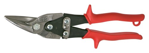

good snips will be a life saver. for down and dirty construction i like the wiss snips. klein screw drivers and pliers are still my go to. a good tool belt with shoulder straps will be handy too

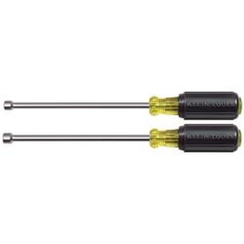

I would start with this set of magnetic long Kleins
www.amazon.com/Klein-Tools-646M-Magnetic-Cushion-Grip/dp/B000936QV0

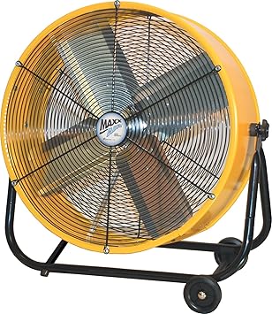

One of these.Light weight. Low amps-HP. Hurricane force. Made in USA.
Remember spring-summer is almost here.
"Help ! My AC don't woik".
It's always in a closet.Down a dark hall. Not a window in site.:sad:
Look at the other guys bags too. They've already asked what you're now asking here and bought the best stuff for the equipment this company works with the most.
http://www.bvc.com/tiltfans.html

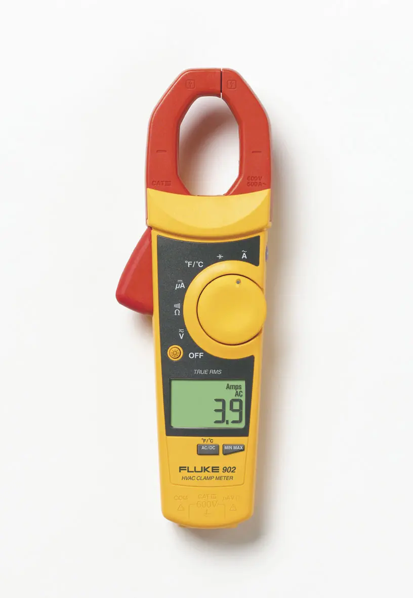

Having been in the HVAC business my entire life, a must is a good meter. I work maintenance at a facility doing heavy commercial light industrial work now and my older body has changed. I go for lighter and multi use these days. 95 % of the time I get by with a Fluke 336 clap meter,sometimes I need to break out the fluke 87.
You will need a capacitor tester ,supco makes a decent one for the $. Swaying tools for copper,inspection mirror(craftsman) for the warranty,5cfm vaccum pump at least,recovery cylinders,recovery machine,Schroeder core removal tool,digital scale for weighing in charges,terminal crimping tools (t&b and klein) both make good crimpers, a mag jumper comes in handy at times also.
I will refrain from listing some already mentioned items that were good also.
I forgot a good valve wrench.
