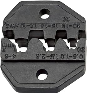

Hi Guys,
I'm looking for the best stuff I can buy for a reasonable price.
I've heard good things about Klein Tools and Channellock.
I bought the wire stripper katapult and a wire cutter, both from Klein Tools:
A couple of days ago, I got to know the Rennsteig tools, they are simply amazing and from what I heard, the ultimate tools to do a perfect harness job, Im right?
But they are a little bit expensive, so I'm wondering what brands should I look?
I need this types of dies to make crimps I need:

If you are looking for a pliers style crimper non ratcheting then the Klein 1005 is your friend.
http://products.kleintools.com/1005.html
I use them daily. I own many different brands of this style and the Klein is the best.
^^^^^ The only time you get a bad crimp with these is when YOU screw it up.
I don't use them daily but I've definitely done thousands of 10-22 crimps over 10 years with the one pair I own and I'm pretty sure they'll last me the rest of my useful life.

Compare the jaws of this T&B setup with the Klein.
The Klein has one U shaped crimp, and one oval. The oval is for insulated connectors. The U is NOT.
This T&B will mess up insulated connectors, but will work with smaller un-insulated crimps than the klein (if you need that).

After deliberating for a while I went with the Ideal crimpers, like new on ebay for ~1/3 of retail. Very pleased with them. Have done a wiring harness for a boat and trailer with no issues as well as 2 other trailers. I have since picked up the T&B's at a garage sale as well as a pretty well used Klein. Ideals are by far my favorite. I've used the channellocks, and they do work fine, but the ideals are much nicer IMHO.
The ultimate is going to be a ratchet crimper, but those get pretty specific and pricey.

I said above that I own many different brands. Last count I have 11 wire cutter/crimpers. Including the Thomas&betts, Snap On, Ideal, channellock. I still always reach for the Klein journeyman's. I use them daily many times a day. I have a set of the regular handle 1005 that's easily 13 years old. Still work great. The Snap On set has the most superior cutter.

I've got the Astro and it seems pretty decent, though I don't use it much. The pliers style crimpers are fine for the majority of what I do and are faster for me. I really only bust out the Astro if I need to crimp a specialty connector. This is the first ratcheting set I've had, so I can't speak to the quality compared to other brands. I do like that the dies snap in without tools. Sorry I'm not more help, but I can tell you the Astro set is not junk.
