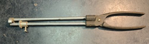

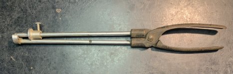

I recognized the tubing cutter in the catalog posted above, so I dug mine out for a few photos. It is marked BARRETT, but I think Goodell-Pratt may have manufactured it; based on how similar it is. I don't think the little thumb screw is original on mine.
I've owned this tool for over twenty years and have yet to use it, but you never know, it might come in handy someday!
