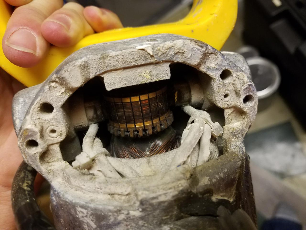

I picked up an old triple-gear reduced Dewalt DW131 and it is absolutely filthy. I'm assuming the grease looks like white colgate (grease mixed with the thinset that is everywhere). I'm assuming any grease is better than no grease but figured I would ask.

Holy ****.....I still haven't messed with the front to lube the gears but I did take off the the back plate and OMG is this thing full of powdered mud/thinset.
There is a bearing right there in the back and it is lifetime lubricated.....good thing because if the shielding/seal was compromised I think it would immediately lock up.

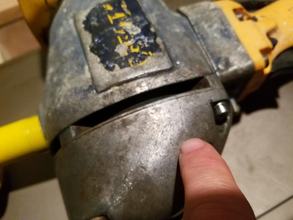

Yeah, I had already saw that post and it basically represents the only pictures of the interior on the internet. I did get the screws off (no match for hammer impact driver) but when I tried to get the gearcase off the entire armature came with it and it didn't split. I wonder if someone messed up the gasket and used some sealant on the gasket or something.
There appears to also have a hairline crack on the gearcase that I'm not too worried about except it means I can't get too rough trying to split the case:

Thanks, now this thing is challenging me to get it open. I might warm up the front gear case with a heat gun to see if that will help loosen it up so it will come apart. Did your gearcase come right apart when you took off the four screws?
I don’t recall it being a problem so I will have to say yes.
