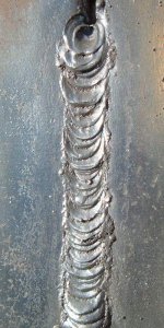

I've been welding for over 30 years and can tell you that/those welds are not good.
I made better looking welds and they definitely had better penetration than that when I was 12.
I would trust my life on my welds but I wont do any welds that others lives rely on.
What is the purpose of grinding the welds you showed us? It certainly wont make them stronger.
AZ Glen
Apr 3, 2006
118
Scottsdale, AZ
I would not own anything that looked like that but you asked a question, here is one answer:
You are going to make it worse trying to grind it.....if you are not worried about safety, just bury it in bondo and sand that down

Use a 4” grinder to clean up the welds smooth, don't cut them out yet. You'll be able to see the condition right off the bat, if there's cracks, porosity, slag holes etc. At least you'll be able to determine your friends ability for your own sake. It'll be easier to cut the joints apart after being cleaned anyways. Since it's for your Bronco...rest assured I don't think the nhra will be kicking in your door & dragging you off to a nhra approved jail cell. Every time I did a weld job that counted whether it was multiple pass column splices on high rises, bridge girders, etc, etc. They were either x-rayed, magna-fluxed, dyed or what ever else they had to do to check them. A “bend or break text” is a low cost test of a coupon that was welded in a controlled setting, not to impressive.
Another side note if you've been a welder, occasionally or even daily for 10-20-30 years & you wouldn't trust another persons life on your weld, then your not a welder.
The only real reason you should grind a weld is to see if there are any pockets of oxidation inside the weld. Then you can re-weld.

It was obvious that the welds were SMAW. Grind them out and cap them with something better like a MIG weld. Stick welding really has no place on a roll bar. That might have been how the racers did it in the 60's, but no more.
And it's true that welds should be seen in their raw form when it comes to structural welding.
I can see porosity and slag inclusions in that pic without having to do any grinding.
