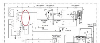

I believe I've located in the schematic where the neutral is jumped to the ground. I can take the panel off the generator in a couple weeks when I have some time and after the transfer switch is in and verify. Thankfully, we're done with hurricanes, at least for the moment. The transfer switch has a neutral wire that gets connected to the neutral bar in the panel, so I think I'm good with grounding when the generator is feeding the house through the transfer switch, just so long as I break the neutral away from the ground in the generator. I like the switch idea. Thanks, everyone.

As stated in previous post if the the transfer switch has a solid neutral (not switched) and your house service is properly grounded with main bonding jumper installed. The generator will be grounded via the equipment ground in whatever four conductor wiring method you choose to connect it. The bonding jumper in your generator should be removed to prevent parallel neutral paths.
