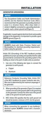

I have a project to place a container on a concrete pad and connect a portable generator. I need to be a little vague because of some proprietary details. The container is like a 20’ conex full of communication devices, it comes with transfer switch and connection points for power, it’s intended to be moveable. The power connection points are camlocks, 5 of them, the generator provides 120/208 4w+g 30 kW. There will be a ground rod adjacent to the container … question is do i need a ground rod at the generator? Renting it from sunbelt, the power cables will be 50 ft.
I am assuming that 30Kw is actually 300Kw since Sunbelt doesn't have 30Kw to rent and MQ doesn't make one. This one can come with cam-locs https://www.multiquip.com/multiquip/DCA300SSJU4F3.htm The grounding instructions are below right out of the IOM.

Sure they do.
This is 30kw standby and below is a link to a 20kw rental. https://www.multiquip.com/multiquip/DCA40SSKU4F2.htm

My thought was Sunbelt has a 20 or a 36 but not a 30 specifically.Sounded like a prime situation, not a standby. Of course we all know about assumptions:sad: The grounding instructions are the same for both generators from MQ. Why would you have cam-locs on such a small generator?
