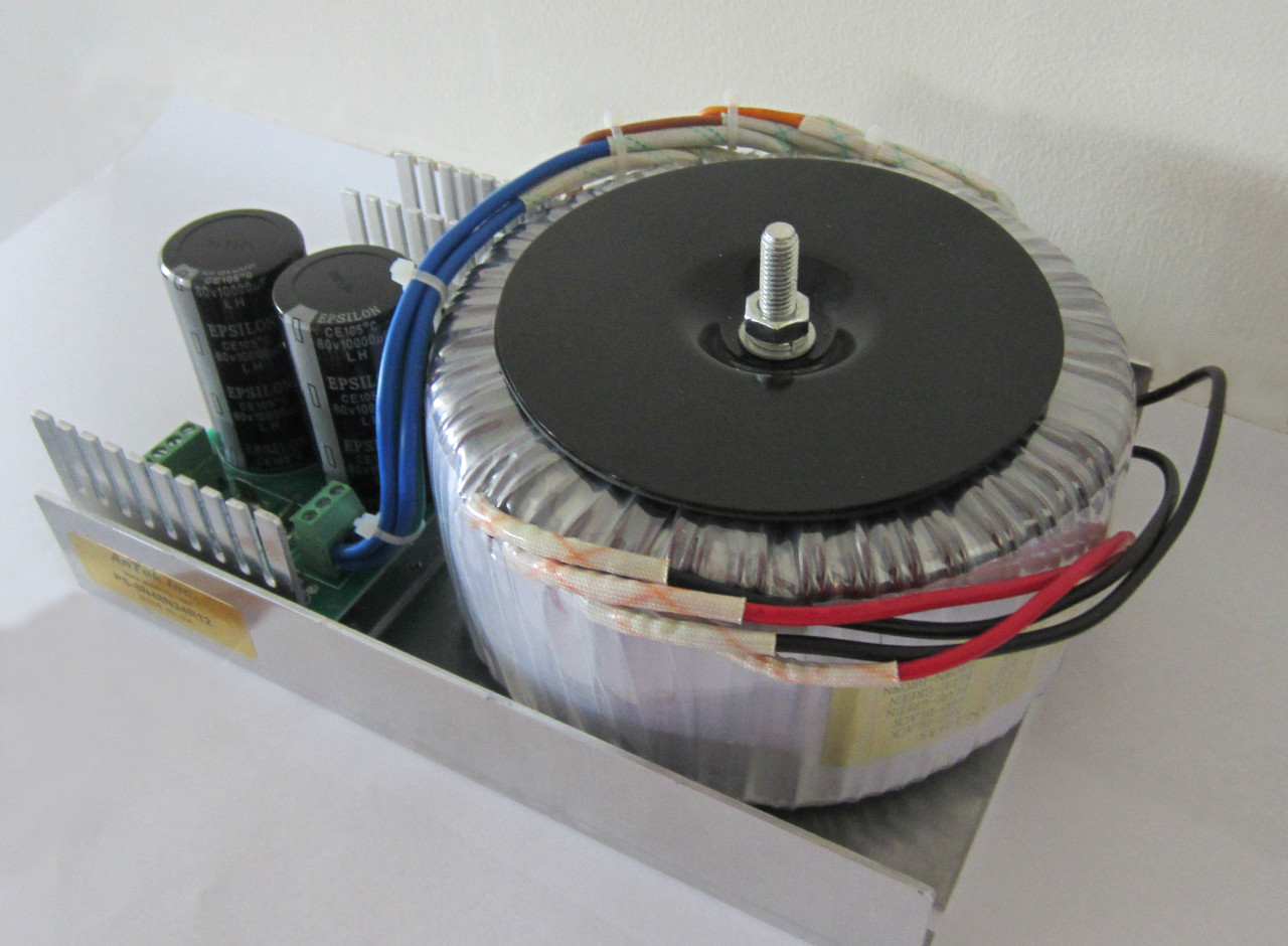

Power supply showed up from Antek today. That is a serious piece of equipment. It is every bit of 20lbs of copper. It came extremely well packed with styrofoam and three over boxes. There was zero chance this thing was going to move and damage it's self in transit. I haven't had a chance to hook it up and outset it yet, but so far I'm very impressed.

I'm up and running on the new power supply.
I'm still having problems with pauses in the Gcode. I ran the same code twice. Once I left the Z movements in the code and allowed the tool to drag during the rapids. The second time I took all the Z movements out and substituted M0 to pause the code and allow me to move the Z axis manually.
