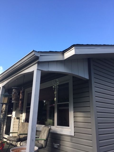

The corner where the eve of the house meets with the roof of the front porch leaves a 10" gap with no gutter. It's surprising how much water comes off this 10" section of gutterless roofline. It splashes onto the driveway, digging a hole in the asphalt and making treacherous ice in winter months. We're getting a new concrete driveway this Fall and I'm motivated to finally fix the problem. The question is, how? Any ingenious ideas? Is there some way to do it without another downspout, by tieing into the exiting main gutter? I'm stuck.

I have a stagger just like that on my shop. My solution was just to put a little deflector up there to kick the water over. It's not that attractive. My deflector is a piece of aluminum facia board cover, simply laying face down and nailed to the roof under a shingle. It's angled so that it's downhill in the direction I want the water to go, of course. If that's not clear I could take a picture.

I dont see why couldn't buy a small peice of gutter and a downspout. Its odd that it didnt get built full length.
You could just extend the roof but thats a lot of work. Or use the diverter mentioned above.

It's a shame they just didn't build that roof ladder just a little longer to meet up with the front gutter. I'm sure during snow and ice season you have a good collection of that on the driveway too.
If you look in the area by the aluminum /gutter material at your home supply store yiu can find something that will work.
Ask This Old House actually did a project like that for someone. Maybe google it?
Much more work would be to add two corner sections of gutter and tie into front. It looks like like tjdux beat me to to.

Find a someone who knows how hand cut a miter in k style gutter and extend it up and around.

If it was me, I'd be extending the roof so as to fill in that section....but that is me and it's most likely not worth the effort.
Filling that in with gutter is a pretty easy task. You can buy what you need at the big box store.
You can pop off the end cap and join into the existing gutter, or add a rain chain and let the water go down gently.

Water coming off of there will also erode your concrete in little time, so if the timing of a permanent fix comes after the cement put something from a plastic sheet to a scrap of plywood will you get it fixed.
Some ell shaped flashing on a angle like that dbl angeled one above will work wonders and it doesn't need to be large or thick either for water. Snow will dictate gauge and height.

First, gutter the short piece above.
Next, I would propose to bend a J-shape in the heavier "gutter stock", its sort of like a trim coil but about .010" thicker.
The J-shape is your water connector. It would get water from a hole bored thru the left end of the short horizontal piece. It would send water thru a slot cut in the back of the existing gutter (may have to be extended about 5"). It doesn't need to be as deep as the gutter, I would think 1" deep x 2" wide would be plenty of capacity. In a gulley-washer rain it would simply overflow anyway and who cares at that point. But should be just fine to handle those pesky drips.
Could also go more advanced with the folding and make it look like an "L shape viewed from the top to dump into a slot cut in the endcap of the existing gutter (that would eliminate the need to extend it)

Run the 10" gutter plus gutter from the top 10" to the bottom gutter...so an L shape. The sloped gutter sits on top of the bottom gutter. Or if you have the money have the gutter guys do it all one piece with the sloped gutter integrated.
