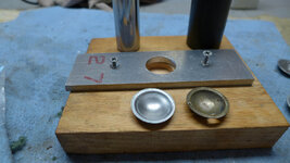

Guys, how would you replicate this ring pull?

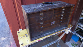

It's from a really old wooden Union machinist tool box and original ring pulls are unobtainium. New replacements aren't even close. The ring part will be easy but I'd like to form the round steel concave piece and have it look like it was machine stamped. Any suggestions using common shop tools? TIA P1090468.jpgringpull.jpg?

Piece of heavy wall DOM tubing and a ball bearing the same diameter as the recess portion. Radius the ID of the tube just so the sheet metal doesn't hang up, insert in press and have at it.

Consider looking at a cup plug (freeze plug) as a part to start with.
Another idea, drill a big hole in a solid block, then lay the sheet metal on it, and press a solid steel ball into the hole. Now you have the hemisphere.

Best idea I can think of is start with the ball bearing idea.
Then drill the right size hole in a piece of steel.
Then you will get another piece of steel with the same size hole.
Put the sheet metal between the two pieces and clamp but not too tight. You actually want the sheet metal to slip inwards a bit to give a little more metal when needed but still keep the rim flat
Then in the press it goes

Guys, thanks for the ideas and the links. I'll just have to experiment. Forming the dimple should be straight forward but keeping the mounting flange flat/smooth/concentric could be a challenge.

That is a Union tool chest. Plenty of them around, usually missing pulls. Keep an eye on eBay for pulls or a crappy box that only has a few pulls.
You might try sending this guy an email, he has restored several. https://terrystoolboxes.com/

Well here's what I came up with. I can replicate the concave portion but I can't get that crisp 90 degree bend from flat to concave like the original. (not that it really matter that much). I suppose it would take precision dies and a factory stamping machine to be 100%. Here's a rough prototype that needs more work. The steel is .028" to match the original.

You're almost there. I'd probably take your part and work on the back with punches by hand to sharpen the corner. I think you'd have to use the hydroforming or press and rubber forming method to get a crisper edge.

I would take a 1/4" steel rod, and file a 90 degree V notch into the end using a square file. Then use that with a small hammer to sharpen up the corner with the piece sitting in the doming block as I work my way around the circumference.
Pay attention to the file's angle, because if you twist it, you'll end up with a more obtuse angle than 90. But don't worry about rocking it in an arc, because a radius on the end is a good thing here.

I think I have a process that worked. I used a socket a little less then the hole I.D. minus a little more then 2X the metal wall thickness. I used the press to just slightly push the socket/pull into block. That caused the lip to raise up. Then I flattened it with a larger socket. It look two gradual passes but I think I have a couple keepers. Thanks for all the great advise.
