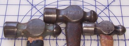

And some quick pics:
I see quite a few of this style:
Channellock, Champion DeArment, and another CL, then Stanley & MAC and the far right is marked "Hand Made"
With a mostly round side boss, Craftsman Vaughn Plumb. I suspect Vaughn made the Craftsman.
And another (newer?) Plumb somewhat different; a Maddox and a No Name all odd variants on the theme. I see a lot of very rough heads finish wise with the completely round side boss and no name on them.
Another variation had smaller that std eye in the head and a VERY thin handle. this gives a lot of flex in the handle in the swing but also prevents a really hard swing, (unless you like replacing handles.) sort of a hammer governor.

I believe you are talking about the octagon pattern and the round pattern.
Right?
Mostly the side panel. compare pic one with pic two. certainly the transition between the faces and the body can go round, hex or octagonal, and that's a difference also.

That could be, especially in the early days, or they may have spun that part off and focused on pliers and such, but it's far from their mainstay these days.
Look at pic one however: The Stanley, MAC and Champion DeArment heads in particular are about as identical as it gets. Even to the slight scalloping into the face sides, compared to the later CL, which have no scalloping, but do have the hex/octagonal

You can read BRASILIA on the handle.
It could have been replaced, but I guess it´s the original one.
Seems like the letters in the head are FB.
Number 5 below the letters is the weight of the head.
