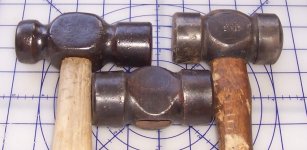

So back to bending horse shoes:
This is what I was talking about: the Grayabr has both faces flat: the other two don't. Is the Graybar for some specific use or just a preference on the part of the smith?

The other two look like lineman hammers. Maybe it was ground down to be a weird version of one.

GINIK
May 20, 2012
97
Gothenburg, Sweden
A double headed hammer with one face flat and the other slightly domed is a rounding hammer (also called a turning hammer). If both faces are the same it is a linesman/engineers hammer (for electrical and utility work). Both Estwing and Vaughan still make a linesman hammer.
Estwing:
http://www.estwing.com/s_linemans_hammer.php
Vaughan:
http://www.vaughanmfg.com/shopping/Products/36-OZ-Supersteel-Linemans-Hammer__L36.aspx
I checked Vaughans catalog nr 207 page 23.
" LINEMAN'S (FARRIER'S TURNING) HAMMER".
Seems to be the same hammer for both jobs. :headscrat

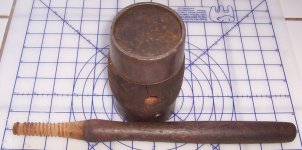

OK, here is an interesting mallet that came my way at an estate sale yesterday:
It looks like a miniature circus stake wooden sledge... Short handle, big heavy head, made heavier as the faces are bound in iron bands, and the handle Screws on!
I don't think this was hand made; I think a factory made it. The wood screw threads and perfect tapers would take some tooling to get perfect, and they do fit perfect.
Not sure if both faces came like this and through use lost the other side, or if this was added. It looks like bondo, feels like a crude plastic... :dunno:
I suspect this thing was made for use with calking irons, and/or wood chisels.

Surreal001
Feb 25, 2014
105
Premier, what is the 2nd hammer from the right, with the pointed end on one side and a flat end on the other?

O
39,355
Outlaw: Could your hammer maybe be what a person cutting cedar shakes with a froe would use? my grand dad had a huge tree limb on the handle of his to hit the froe with, but maybe yours was modified with the metal to keep it from splitting.
nice looking hammer and plenty old looking so nice find no matter what use you intend to use it for.
I don't think so Dif, as the iron band sticks out past the edge of the wood so you would have metal hitting the metal. I'm also leaning to both faces may have had an insert, and the rings, being tapered, also retained the insert. But really have no solid info. :dunno:
drivesitfar
Oct 23, 2013
36,086
I saw your metal was sticking out beyond the wood, but you know how those old guys didn't mind beating their metal on metal if it fixed their tool. i'll keep watching to see and hear if somebody else has a better answer.
how many chisels or metal wedges have you see with the metal curled over? those froes could have probably been hit with steel hammers if the froe with the wood head wasn't handy.

O
39,355
I'm sure some were, I've seen them beat to death, but hitting an edge with the edges of that ring, vs. a steel face with a steel head hammer would quickly destroy the mallet.
