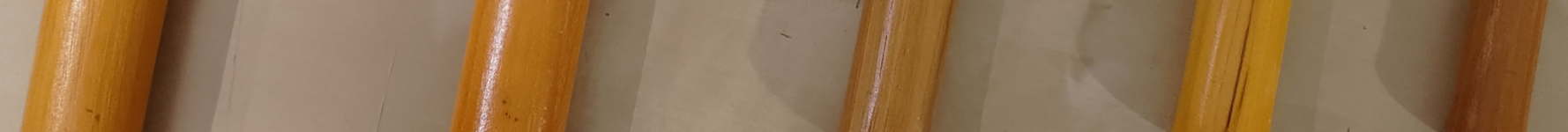

How much variation would you expect in hickory colour?
I've just got a few of the same model in different sizes, one store order. Good brand, too.
Photo might not really do it justice, but I've got orange brown x2, light brown, yellow brown, and plain brown. I guess from different batches.
Perfectly functional of course, and it's a natural material.
Learning from Google:
Hickory wood contains both sapwood, which is the lighter outer part of the tree, and heartwood, the darker inner part. The sapwood is typically light, while the heartwood can range from light brown to a rich, dark brown or reddish-brown
While sapwood offers ease of workability and is cost-effective, heartwood provides superior durability and resistance to environmental factors
Right, cheaping out on materials.
Here's someone's photo of old stock in the same model:
Don't forget the finish, which can change the color of the wood. I wouldn't trust it without sanding down to clean wood.
30,025
A LOT.
In 2002, I sanded down the handles of all of my outdoor "garden tools", and then stupidly painted the handles with polyurethane - a really bad choice. Handle color varies from one to another.
Most all of these are original handles. Some have been replaced. I have always been really picky about handles - I drove all over town for the last two. (Hammer and axe below, sealed only with boiled linseed oil after sanding to bare wood.)
I don't really think "color" is as great a concern as finding a piece of wood with nice tight grain.
I can't see much reason for a manufacturer to randomly vary the finish substance, whereas variability of natural materials (e.g. parts of the tree, different batches) and cost cutting seem much more likely.

Nice tight grain and the grain in line with the swing of the hammer/axe etc. Some will have the grain of the wood going side to side and these easily break.
The set above are: inline, 45 degree, across, across, inline.
Another one I have from Halder, goes from 45 degree to across. I've seen a video of PB Swiss one also being 45.
Based on that, I doubt any brands give a damn.

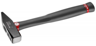

Why would you want a rectangular face on your hammer?
French pattern riveting hammer, 620g head, 36x29mm
German engineer hammer DIN 1041, 600g head, 30x30mm
Maybe the step in the wedge is to free up some weight which can instead be put towards a larger face.
Then make a tall narrow face to get into smaller places? You couldn't get a short wide face into anywhere anyway due to the swing arc.
Hammering in square corners.
Before you ask, The flat sides are used to "Set" Pittsburgh seam as one example.
This is common in sheet metal work and apprentices and Journeyman are required to have a sheet metal hammer on the job. Union rules. (A buddy had one show up with a carpenters hammer - he sent him back to the union hall.)
I believe you are trying to be analytical about all these questions. You should try doing some study of what people actually do with these in their respective trades, instead of criticizing hammer designs.
Yes, I understand that for non-round hammers. A square hammer would also do, so why rectangular?
Yes. I hope I'm not asking too many questions for people's liking - I figured this is a hammer thread on a tool forum after all. Thanks for your answers.
I absolutely am doing that by reading, and asking here when I have remaining questions.
I don't believe I've done that. Asking questions isn't criticising - I genuinely ask because I want to know.
The only thing I've offered an opinion on is the unusual mini sledge, where I said personally I didn't like it, and conceded it may well be excellent for some purposes or after getting used to it.
Found an answer here https://www.iforgeiron.com/topic/6005-french-pattern-hammers/
Made for riveting during construction of the Eiffel Tower. The shorter head allow use in confined spaces, as do the other design differences presumably.
The following photos are of different sizes and handle material, but for comparison:
  • Facom 200H.30 (French) hickory - 570g head, 100mm long head, 30mm face height
  • Facom 205H.50 (German) hickory - 580g head, 122m long head, 27mm square face
  • Facom 200H.1 (ball pein) hickory - 430g head, 104mm long head, 31mm diameter face
200C.40 (1000g)
205C.50 (580g)
