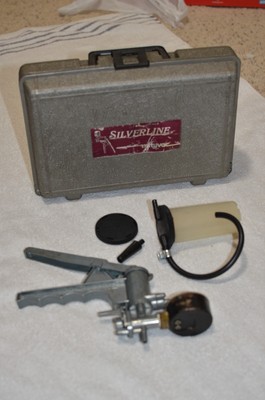

I don't think Mityvac is as good as it used to be but, that's just my opinion. I have a real old silverline kit that's been rebuilt more than once. Quality wise, it seems much more robust than a newer kit we have at work. The bottom line is that if you're using once in awhile for vacuum testing, I think probably the ones from other brands will do just as well.
