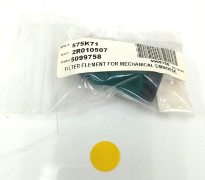

For anyone that needs it, I believe this is the coalescing filter for item# 58180
I'll add others as I find them.
Do a Google search for "Norgren 4444-01"
This is the one I bought to replace the filter catridge in my Harbor Freight 58180
Cheapest one I found is $30, here...
