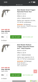

What would you guys recommend? A trigger gun or one with a foot valve ?
I would prefer finger trigger ( if so what model cdn would be best?
I’m using a 90 gallon air compressor so I have a lot of air

alfadan
Mar 9, 2007
2,145
Augusta, ks
I use a trigger gun which looks like the above. I can get a little tiring to the wrist during long sessions, but I take breaks.
If you get pedal later, you can always ziptie the trigger down.
Good idea
Should I get the 4-8 cfm or 10-15?
I don’t know how to calculate that
