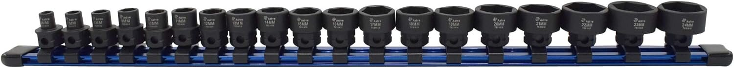

Something like this for a Honda,
A socket that has flats for a wrench so you can put a hex key down the center to hold the shaft. No, an offset wrench won't fit. Ten bucks online but don't see where I can get it locally tomorrow. Nothing at Harbor Freight. Haven't checked Snap On but not paying $50-$100 for one either. Any other places that sell tools like this?

Not locally but Amazon is full of strut sockets.

Just use any 18mm socket that will fit and clamp a vice grip onto it as tight as she'll go. Or... tack weld on a scrap piece of flat bar to the socket
Edit - just saw your reply above to cvairwerks. The threaded rod is part of the shock.... you can wrap some cloth around the upper part of the shock (under the cup ... where the spring is) and clamp a vice grip there, preventing the shock from spinning while you tighten the nut to spec.

You could also cut a window in a sacrificial socket. That's what the strut sockets are.

Pass Thru socket set, Klein version should be at Lowes.
Maybe a Deep Impact socket that you put vice grips or a pipe wrench on, and then put your hex key through the square drive opening on the bottom?

Or use an angle socket wrench. I introduced Eric O. to these years ago and that's what he uses for struts. Your chance of finding one of these locally is ZERO.

Lots of sources for pass through socket sets. I seldom actually use mine but struts are a perfect example of why one should have a set. Not going to pay tool truck prices for something like this - so the HF option for y'all sauwth of 49 sounds good.

Grind two parallel flats (carefully) on your 18 mm socket and call it good. It isn't going to weaken the socket significantly and you'll be able to get plenty of torque on it to tighten it when you reinstall.

a pass through socket set is what you need.
When I didn’t have those back in the days or can’t find a speciality socket that those wrench fittings. I just used a deep socket and a good locking pliers works fine. The vw uses 21 or 22 mm nuts even the after market bilstan is the same.
You can always scrafice a deep socket and weld a handle to it…

In a pinch, and for a one time use, I'd pick up the cheapest 18mm (or whatever size for the task) socket and grind some flats on it. Who cares what it looks like, if you grind through, etc. It's only got to work once until the correct tool arrives (which will then sit unused in your toolbox for 13years).

I've always just tightened them with an impact gun.
Same here, when I worked at a shop I've always just used an impact wrench to loosen & tighten, never needed to hold the center shaft unless I was using hand tools at someone house & no access to air (cordless impacts didn't really exist yet back then). I've lowered hundreds of cars during that time, most of them were Hondas.
