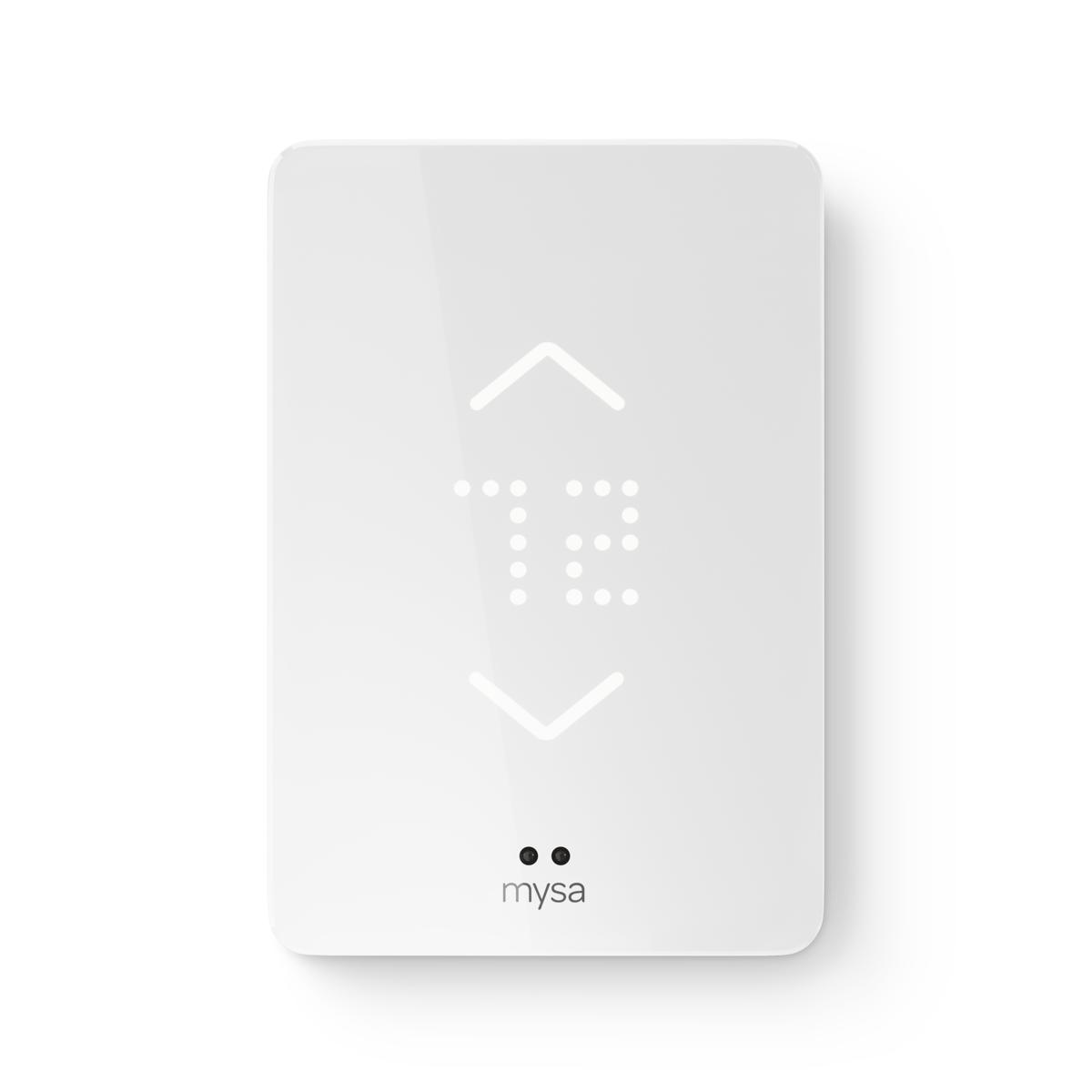

you can get wifi capable line voltage t-stats. Something like this seems to fit the bill
or
Anything with WiFi will need continuous power. On 24V thermostats that's why you always see posts about running a "C" common wire to complete the circuit for continuous power.
In this case, the line voltage thermostats with WiFi will need either a neutral (if 120VAC) or the opposite leg (if 240VAC).
For your heater, we can still use the thermostat T1/T2 connections, but you'll need to pull off the opposite leg (L2). You'll need to use a 3 conductor cable (14-3 Romex for example).
