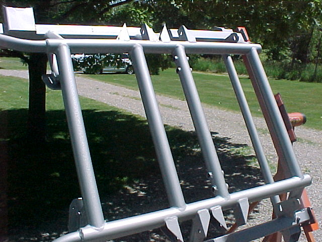

I spray the hammered Rustoleum's a lot. I use Xylene to reduce it and generally follow the instructions on the can for reduction ratio.
I sprayed this custom chassis with silver hammered, reduced with Xylene and hardener added, it was rock hard in an hour.

Looks good mark. The paint isn’t to soft or doesn’t mar easy?
astroracer
Jun 22, 2005
3,001
Mid_Michigan
No, not at all! The hardener makes it rock hard in a very short time. It is no where near "soft"... Without the hardener it can take days for the paint to set up and get hard. The added hardener speeds up that process greatly. :)
