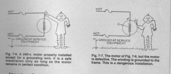

Mark , you are failing to understand what I said, and misunderstanding the difference between a ground fault, and protections from shorts, (ground faults) not protected by a GFIC...
You are also apparently not very conversant with the history of electrical protection systems and what was in place long before things like GFIC existed.
First; I never said grounding "Cleared the ground fault". I said it is your first protection in the event of a short circuit to the motors chassis.
Second, that internet site you are quoting appears to bite it's own tail in the subject of lightning protection:
Grounding and bonding in grounded systems. The NEC requires you to ground (earth) system windings to limit the voltage imposed on the system by lightning, unintentional contact with higher-voltage lines, or line surges[/B] (Sidebar below). Another function of this earthing is to “stabilize the voltage to earth during normal operation” by providing a common reference point.
In addition, grounding (earthing) the metal parts of electrical equipment doesn't protect electrical or electronic equipment from lightning-induced voltage transients (high-frequency voltage impulses) on the circuit conductors inside the building or structure. Nor does it protect equipment within a structure from transients generated from other equipment in that structure.
Getting a more historical look at this from "Wiring Simplified" by H.P. Richter (first published in 1959 and updated yearly for the past 78/9 years to meet current NEC codes..), demonstrate that indeed, protecting people from shock was the primary reason for grounding being added to the circuits.
Are there better ways to protect people? Yes, GFIC for one... But the fact is, grounding while it does not "clear the ground fault" DOES provide a significant level of safety in the event of a shorted motor.

You still don't get it.
It says "Grounded connection at Service Equipment" in your book.
That is a CONNECTION TO THE NEUTRAL A LOW IMPEDANCE PATH SUFFICIENT TO PROTECT YOU AND CLEAR THE FAULT . . . not the ground rods, sigh. Grounding protects people BUT THAT ISN'T the GROUND AS IN THE EARTH. Technically, you are confusing two different things
1) the EGC or equipment grounding conductor - the green or bare wire tied to metal in the system - this system prevents shocks and death - it is connected to the low impedance neutral at the service, and
2) the grounding electrode system - which exists for the purposes stated above which are not to protect from shocks and death
a) lightning
b) reference neutral to earth or around 0 Volts so your lights and other electrical devices run steady at around 125 Volts.
c) dissipate static
d) utility fault clearing
Nothing I have said has anything to do with GFIC. A ground fault is a fault of line or neutral to ground. A GFCI is a special device that monitors the current passing through it on the line side and the current passing back through it on the neutral side and can detect if a tiny current on the order of 5 mA is lost through a ground fault. It will then trip on this amount. This device has NOTHING to do with anything being discussed by me.
I give up.
MrMark
Jan 25, 2010
4,626
Southern Cal.
Let me just tell you that the dirt path that you seem to be enamored with is very high impedance relative to a piece of wire. Let's say the dirt path is 70 ohms. Your body is even higher resistance depending on man or woman and the path. Let's say 200 ohms through your body.
Two parallel paths, one 70 ohms and one 200 ohms. Current splits in inverse proportion to the resistance. You tell me how that dirt path is going to save your life when it only takes milliamps to kill?

OUtlaws, do this test for me to see if the earth and your ground rod protects you like you interpret that 1958 book to show (be wary of anything regarding electricity that has "simplified" in its title, that picture is misleading without clarification so I can see how you got your ideas no matter how wrong):
1)open the neutral on your service so that the only return path you have is through your grounding rods, ie. the DIRT.
2)Next, touch the drill motor just where that book shows you will be safe to do so. Show your faith in your book.
3) Finally, report back your results. lol.
