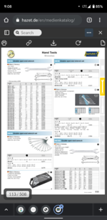

A bit late to the party but here are the thicknesses for a couple different sets of double open end wrenches I took screenshots of.
I ended up with the Taiwan made Gedore Red set plus two hazet 450 wrenches for the missing 26 & 29mm ends.
