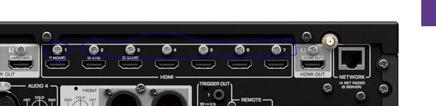

Hi all,
I'm looking at a new AV receiver (Yamaha) and noticed the HDMI ports each have a screw above them. I'm thinking it's a grounding screw, but don't know what to connect to it as HDMI cables don't have an auxiliary ground cable.
Can anyone out there explain the use of that grounding? screw?
TIA

I've never seen an HDMI cable with external ground. Old receivers used to have ground terminal for turntables but they were typically marked as ground. Are you sure they are just not physically holding terminals to the case?

Probably not grounding screws, but holding the connector.

I'm in the holding the terminal to the case camp too

Is that part of the HDMI cable or ?? I've never seen such an attachment before on any HDMI I've bought, and I've bought a few in past few months.
That would be the connector inside the receiver, a screw and nut fasten it to the back panel.
The cable plugs into it.

Posts #2 & #3 nailed it, screws hold the HDMI receptacle to the case of the receiver.

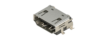

Yep, it's a mounting screw for the jack. If it wasn't there the jack would be very weak and pop off the board with the slightest torque of the cable plugged into it. They are only soldered with surface pads.

The frame sometimes is through-hole for added stability, but the leads are surface soldered.

Which is not true, and these are not normally considered SMT. I've been dealing with similar connections for months, I can't go into many details but can assure you these are not processed as SMT, and are usually fairly solid with the case soldered through. The fact that Yamaha is using additional mechanical mounting is good.

Right, like I said the case is soldered through-hole sometimes. But the leads are surface-soldered always. I have never seen an HDMI lead connection through-hole soldered. I have seen HDMI connectors only surface-soldered with reinforcements that are also only surface soldered:
No through-hole mount, and no screw-ear, nothing. These are the jacks I was referring to, being easy to snap off the board. Having worked on literally thousands of consumer electronics, I have seen them ripped off or jammed backwards into cases more times than I can count.
