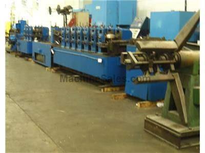

my buddy Joe Miller used to bend all Roger Penske's Inconel pipes.......the dies, wipers and clamps were locked up and only the General Manager had keys to them and used them, they had a master tool and die maker in house that made them
my buddy Donnie owns FMF, we made 900' of Ti tubing one morning screwing around.....you think we used stock Yoder Tube Mill rolls?????
won't work, the Ti galls horribly on stock rollers, wrong material.......master tool and die maker in house too
you think that tube mill is CNC??? don't kid yourself
http://www.machinesales.com/images/0000292665.jpg
you know those Semis you see with the 5' dia. rolls of sheet on them? thats how he buys Ti:thumbup:
