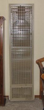

I've worked in shops with a hanging heater and glad I'll never need to do that again unless they give me a real tall ladder to work from up there where the heat is.
Look at how little space an wall furnace needs and they can be bought to function with a thermostat without purchased power. Try backing up to a hanging heater to warm your ****.:)
