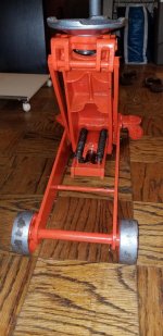

Hiball. i did the bleeding already. I did the air purging , too. I wasted so much oil refilling. Could the damaged plunger assembly has something to do with it? Remember the plunger that I damaged while drilling the bottom plug ( refer to #472 thread)?
Hiball, I did not touch the ram assembly cuz I could not open it although i tried a lot of pounding and heat to unscrew it. I hope I did not damage anything inside like the seal or gasket?

Steve, why would the plunger not function when I was using the handle, and works when I used the wood to push it down manually? Isn't that odd?
Yes, I did remove it. Here is what I will do. I will remove the cylinder from the body again. I will open all the valves except the valve on the side for weight limitatiom protection. I will remove all oil, flush all holes with new oil and dust off air cannister, and reinstall them. Is that ok? I will inspect the new plug I installed at the bottom hole. Anymore suggestion?

Nope, wouldn't be the plunger cup. Are you sure that the leak isn't coming from around where the rod enters the top nut? If so, there's a packing nut that you can tighten. Otherwise, you may have to drain, disassemble, clean, and apply some Loctite 518 to the reservoir edges, then reassemble.Hi, I'm reviving an old thread to ask a couple of questions.
I'm getting a leak after rebuilding a jack that seems to be coming from the reservoir tube where it seats on the top nut. I've tried to apply more torque to the top nut without success in sealing the metal to metal joint.
I also had some issues getting the piston seal into the cylinder and may of damaged the plunger cup which in my rebuilding kit was made of a polymer as was the one originally in my jack.
If the plunger cup leaked, could that result in excess pressure in the reservoir tube causing the leak?
I'm going to head out to purchase the proper wrench for the packing nut but I really think the metal to metal seal is where the leak is because I saw some air seeping out of the seam with some fluid when I turned the jack over. I used an anaerobic gasket material on both ends but I think that the gasket material squeezed out by twisting the top nut. I'm wondering if I need to polish end of the reservoir tube to remove any imperfections.Nope, wouldn't be the plunger cup. Are you sure that the leak isn't coming from around where the rod enters the top nut? If so, there's a packing nut that you can tighten. Otherwise, you may have to drain, disassemble, clean, and apply some Loctite 518 to the reservoir edges, then reassemble.
This might work but I'm not sure about the size:but where on earth are you going to head out to, to buy a spanner wrench? I can't imagine any where local to me having one in stock.
I'm not sure that's going to get it tight enough - you can try getting two dowel pins in the "scallops" on the tank nut, diametrically opposed, then use a large pipe wrench to bear on them. The pins will keep you from scarring the tank to nut interface, but you will need at least a 2' pipe wrench, I use a 3 footer plus an extension.I'm still getting some leakage from the front end of the reservoir after polishing the end smooth and using anaerobic sealant. I'm using a metal pin and hammer to tighten the nut.
