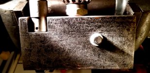

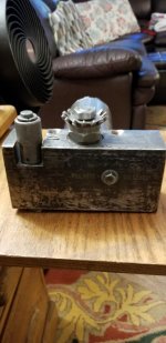

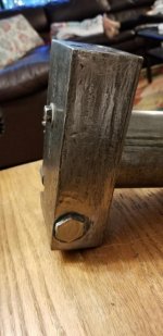

Hiball, help!!! I messed up the plunger when drilling the bottom hole. I must have drilled too deep and It damaged the hex screw, the washer, and bit a part of the bolt. I ordered the same size of hex plug, 14-28, and I plan of using a JB cold weld on the damage bolt before screwing back to reinforce the plunger.
Yes you did... Lemme see what I got laying around the NOS pile. When you thread that nut back on to secure the washer against the seal, it needs to be somewhat uniform. I haven’t used JB weld enough to know how it reacts to cutting threads etc. After all this trouble, I should have recommended hitting the guide slot with a punch to try and loosen it, it would have definitely deformed it, but I think you would have been time/trouble ahead.

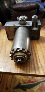

At last!! Here is my cylinder ready to be painted.

As I have promised, here are the pictures of my fully restored, painted Hein Werner WS. It took me awhile but i finally did it!! Better late than never, right?
But I hit a glitch again and I need your expert advice on this especially Hiball, who without his help I would never have done this, much less finished it.
Steve, the jack will not lift up, not even a slight twitch with the saddle when i pump it up using the handle. I poured 8 ounces of new oil, pump it several times with the oil plug unscrew, and the handle knob in the released position (counter clockwise). I screw the plug, rotate the knob handle to lock (clockwise), pump the piston, nothing happens? I tried everything that to purge air and refill oil again ( i must have used a quart of oil already) but could not extend the arm up. Then I tried one of your advices with this problem which is to lock the knob position, raise the saddle manually without pumping the piston. With this method, I was able to lift up the arm around 6 inches. It stays extended, then pump the handle to extend it farther up but it would not lift up despite the arm showing slight movement of up and down while pumping the handle. When I release the knob, it will go down smoothly. Here is the weird part that I found, I turn the knob lock position, lift the arm manually as far as possible, let it go ( it stays extended), then instead of using the handle to pump the plunger, I used I 2x4 stick of wood to push down the piston little by little (it is not easy cuz the plunger is hard) and I was able to extend the arm fully ( see the picture).
Question, why would the plunger work ( i have to initially manually lift the arm) using the wood, and not when I am using the handle to pump it.? The plunger feels spongy, and only seems to get harder when I lift the arm manually. but would not lift when I used the handle, but would function when I pump it with the wood??? Please help, Steve.
