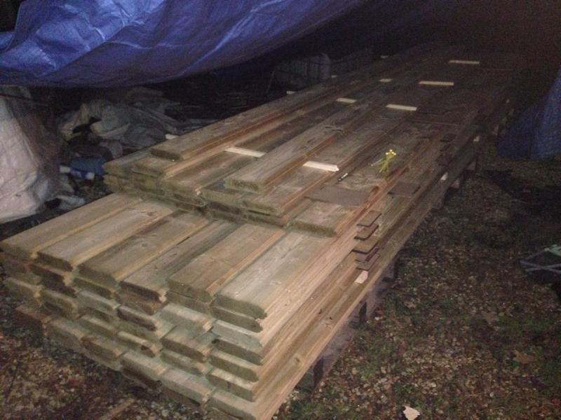

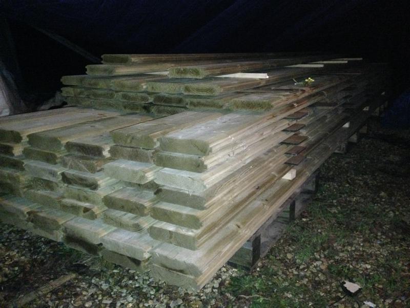

I bought 44 x 6.1M long and 18 4.5M long, I think this should be very close to what I need with a good 10 to spare (for errors)
I’ve placed them on a flat base (timber pallets) under a tarpaulin with thin timber separating each row to allow them to dry as when I picked up the timber most of the night before and on the day of picking them up it was raining
