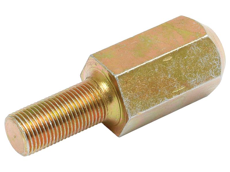

I'm not sure where this belongs as it's more of a wanted thread but the solution may require some fabrication if the part doesn't exist.
I have a New Holland round baler that I want to put dual tires on. I found this dual adapter for a Ferguson tractor that is the wrong size BUT it leads me to believe there may be other sizes available that I cannot seem to locate with the level of Google that I can muster up.
My baler has 5/8"-18 threads in the hub and I intend to use threaded rod to bolt the duals on. They will come off when not needed so I cannot just use one single long piece of threaded rod. I've thought about doing a short stud through the factory rim with a coupling nut sticking out to connect the dual hardware to but figured I may as well ask on here to see if anyone knows if this exists in the size I need.
Thank you in advance !!

Check the pitch chart, but I believe these will work:
That is exactly what I was looking for !! Thank you !!

I test fit the duals to the baler to make sure they would actually fit before spending a couple hundred bucks in hardware and it's perfect. They ride about 2" off the ground so there will be minimal stress on the baler when the baler is on dry hard ground. I'm going to order the dual adapters and some threaded rod tonight and bolt them on. I'm pretty pumped !!

I needed a longer socket so I used my socket stretcher on an 1-1/16" SnapOn impact socket. It turned out decent so far. Needs paint and the "SnapOn" stamped back into it. It got all melty when I welded it together :lol_hitti
These 5/8-18 threaded rods are both lug studs and lug nuts. There is a 3/4" nut welded onto the end of each of them to drive them in and the 1-1/16" nut will act as a lug nut to hold the duals on my round baler.
They are mocked up here before welding the nuts on the end of the rods. I trimmed them down a bit but the need for a longer socket stems from not knowing which way will work best to have the dual on the baler. I can take the center spacer out and flip the dual around and it'll stick out around 4" more.
They thread into the dual adapters that stay on the baler when the duals are off. I'm pretty stoked to use these things in a few days !!
