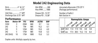

Morning all. Over the holiday weekend, I picked up an IR Type 30 Compressor for the garage. I am struggling to identify it and IR's website is no help. It is a 5HP, 80 Gal with a 242-5D Pump head on it. It also came with a spare pump head but it is a 242-5C and has three intercooler lines vs one on the 242-5D. My questions are:
1. Where do I find the tech specs on this so I know what kind of air it is putting out, etc.
2. Where would I find the wiring diagrams?
3. How can I tell how old it is?
Thanks all!
